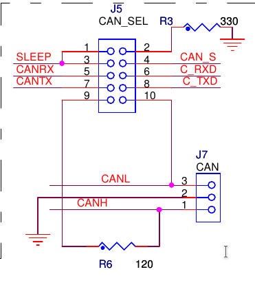

Hi Guys,
the flexcan_interrupt example does not work for me with MCUXpressoSDK 2.5.0 at all. I followed the the steps of the readme.txt but  since I have only one TWR-K64F120M+TWR-SER set of boards, I used a FRDM-K64F + self-made PCA82C251 board. I copied the board related files ( pin_mux, board, clock_config ...)  from the loopback example of frdm-k64f. Additionally I added the initialization of the pins PB18 &  PB19 like it is done for TWR-K64F120M. I measured the signals of CANL and CANH  and it seems ok. Any Ideas what could be going wrong here ?

Hi Daniel,
thanks for checking on your desk. In the meantime I got it working as well. There were different problems together.
One of them which could be interesting for others was that the pin numbering of TWR-SER-SCH.pdf is:
and the readme.txt of flexcan_interrupt demo says something different:
      PINS NAME        TWR-SER1     CONNECTS TO    TWR_SER2
      CANL                   J7 PIN 1                                          J7 PIN 1
      GND                     J7 PIN 2                                          J7 PIN 2
      CANH                   J7 PIN 3                                          J7 PIN 3
Sure if you have two twr-k64 +twr-ser combos it will work since you are doing the same failure on both sides...
Johannes

Hi Johannes:
I did a quick check  the flexcan_interrupt demo with two twr-k64 boards, it can work on my side.
