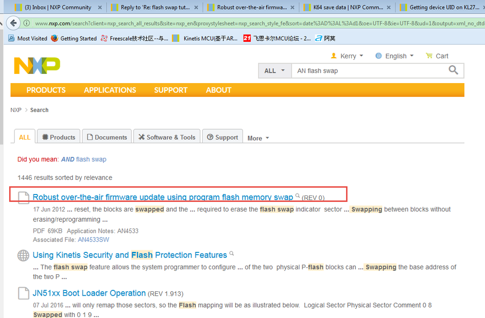

kerryzhou
Hi E Engineer,
  Actually, you can input the keyword in the search from our nxp website, for example, you want to get the flash swap an.
You can find the first one is what you need.
Wish it helps you!
