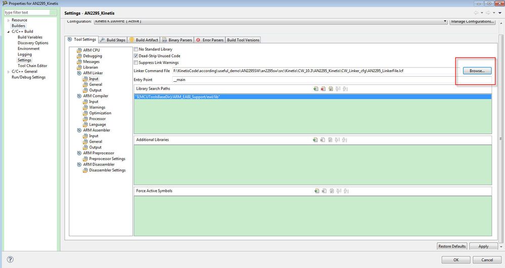

Hi wang baode,
     Please downloader a new AN2295, then do the next steps:
  1: remove bootloader_asm.S
  2: change the path of AN2295_linkfile like the following picture:
click browse, choose "AN2295_LinkerFile.lcf" in your folder, then click"apply".
After that , please build it again, you will find there has no error!
Wish it helps you!
Best regards!
Jingjing

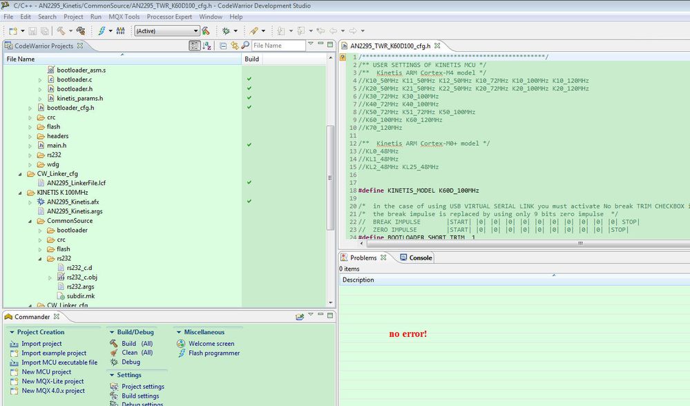

Hi wang baode,
    Juan is correct, about the error of bootloader_asm.s in codewarrior, please just disable this file by clicking the draw behind the bootloader_asm.s, then this file will not take part in building.
    After that, rebuild the project.
    If you still have other error question, please let me know!
Best regards!
Wish it helps you!
Best regards!
Jingjing

2,296 次查看
juannava
Hi wang,
I had the same problem and I was told to comment all the code inside bootloader_asm.s to make it working, apparently this is code for Keil compiler, but for some reason it gets called by CW 10.5.
Other option is to disable this file by clicking the draw behind the bootloader_asm.s and building again as follows:
I hope this help you because it worked for me.
