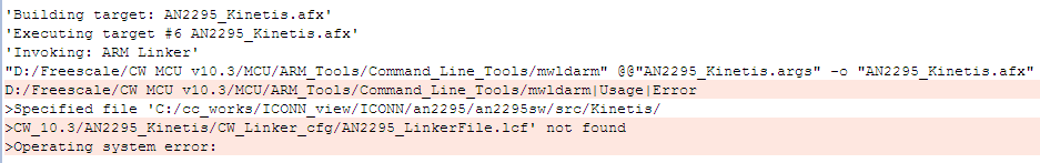

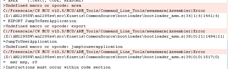

hello everyone,
when I build AN2295 Kinetis bootloader,some errors displays on console of codewarrior 10.5.
is there anybody meets the question?how to resolve it?

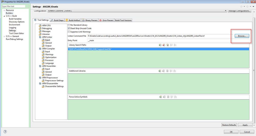

Hi wang baode,
     Please downloader a new AN2295, then do the next steps:
  1: remove bootloader_asm.S
  2: change the path of AN2295_linkfile like the following picture:
click browse, choose "AN2295_LinkerFile.lcf" in your folder, then click"apply".
After that , please build it again, you will find there has no error!
Wish it helps you!
Best regards!

kerryzhou
Hi wang baode,
    Juan is correct, about the error of bootloader_asm.s in codewarrior, please just disable this file by clicking the draw behind the bootloader_asm.s, then this file will not take part in building.
    After that, rebuild the project.

wangbaode
hi jingjing,
I remove bootloader_asm.S and rebuild the project. I meet another error as follow.
pastedImage_0.png !

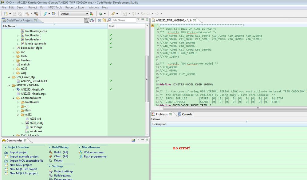

wangbaode
Hi Jingjing,
Thanks for your answer.your answer is right and I hve resolved the question.
best regards for you
bye

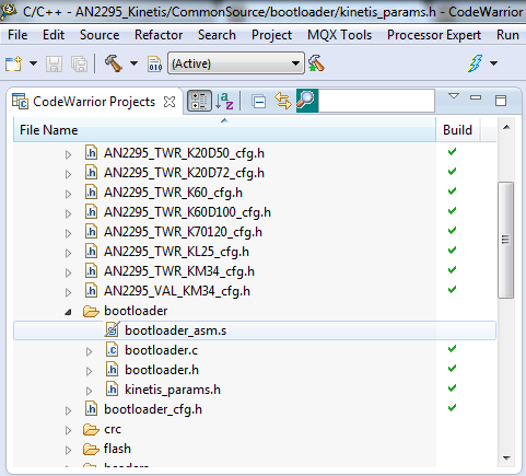

juannava
Hi wang,
I had the same problem and I was told to comment all the code inside bootloader_asm.s to make it working, apparently this is code for Keil compiler, but for some reason it gets called by CW 10.5.
Other option is to disable this file by clicking the draw behind the bootloader_asm.s and building again as follows:
I hope this help you because it worked for me.
