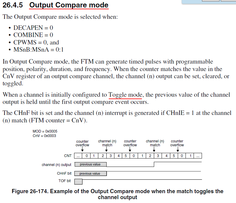

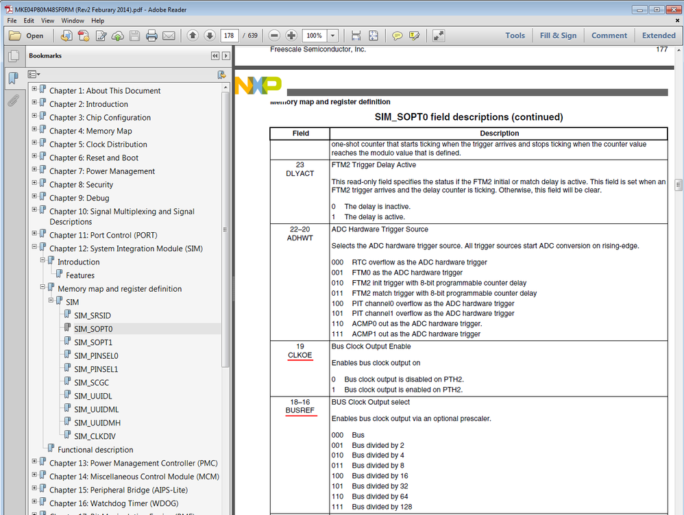

I need a clock source ( 8-16 mhz ) to  feed ic .  what is the suitable method in ke04 family to generate this ?

1. Using PTH2 output bus clock. You can also enable bus clock output via an optional prescaler.
2. Using "Output Compare mode" of FTM module. It can be configured to Toggle mode.
