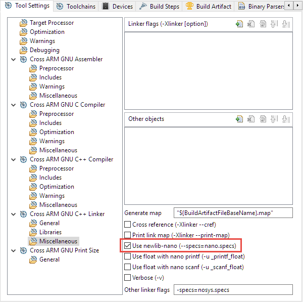

hello everyone:
i have downloaded the file:
Micrium_FRDM-K64F_OS2-KSDK.zip.when i build it with KDS,  it show:
error: unrecognized command line option '-nanolibc'
1 解答
2,226 次查看
BlackNight
It seems that this project was for an old version of KDS (probably v1.0?) with an old GNU toolchain. The most recent version is V3.2.0 and it uses the option --specs=nano.specs instead:
See as well Switching ARM GNU Tool Chain and Libraries in Kinetis Design Studio | MCU on Eclipse
I hope this helps,
Erich

dugg
thanks for your answer!!!
