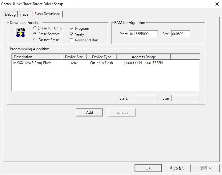

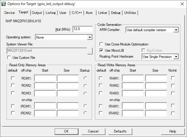

I think MK22FN128VLH10 has 128KB flash which address is from 0x00000000 to 0x0001FFFF.
However, according to above messages, flash writing seems to be uncompleted.
May be I have something mistakes on settings, I'm still uncertain them.

I've attached the bitmap.
Where can I download debug I/f guide from ?

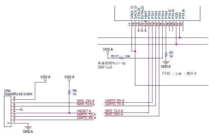

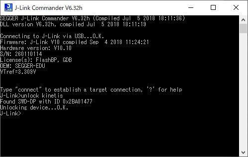

jeremyzhou
I was wondering if you can share the schematic of debug interface, in addition, whether the K22 would be recognized in J-link Commander, if yes, please input 'unlock kinetis' to free the chip, then try to program the K22 again, please give a try.

shuichiy
Thanks for your reply.
I have input 'unlock kinetis' then it succeeds, but the situation has not been changed.
I've attached the schematics.

jeremyzhou
I was wondering if you can share the screenshot of inputting 'unlock kinetis' in the J-link Commander.
From the experience, I guess it's the hardware issue, so I've attached a guide of design debug interface, please refer to it for details.
