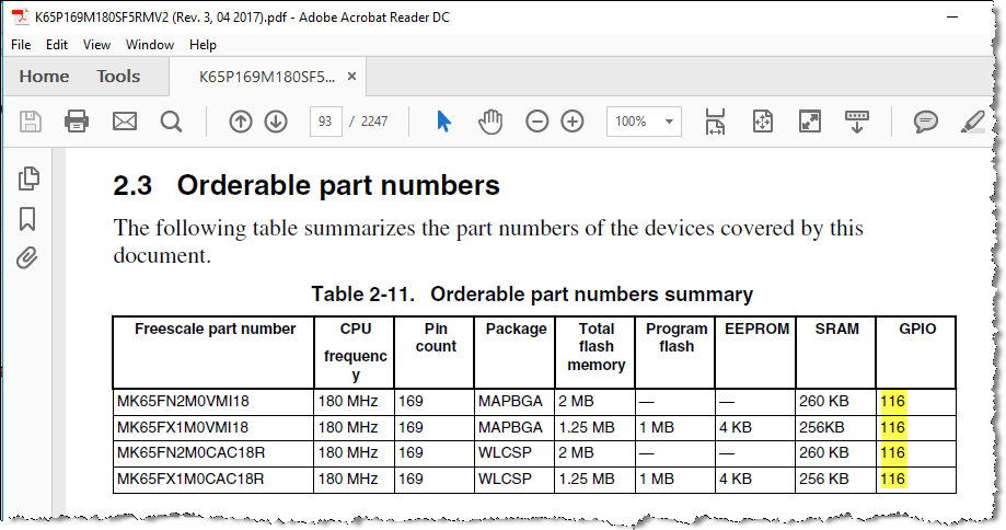

Robin_Shen
116 GPIOs
You can find this number in Data Sheet or Reference Manual:

mjbcswitzerland
Specialist V
169WLCSP has 147 function pins / 116 GPIOs
169MAPBGA has 147 function pins / 116 GPIOs
144LQFP has 100 GPIOs - K65 not available in this package (but valid for K26 and K66, which have same footprints)
144MAPBGA 100 GPIOs - K65 not available in this package (but valid for K26 and K66, which have same footprints)
Corrected 18.10.2018
