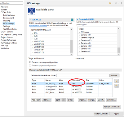

I debug the BootLoader for MKE06  ,  use mcuxpresso(11) IDE ,I want to modify interrupt vector table start address,"MKE06Z4_Project_Test_Debug.ld" files not allow to change;
how to do ,please ask me, thank you!!

danielchen
Hi @ahjg_xu
Please try to change the address as below picture.

ahjg_xu
thank you for your help !
but,I have a question,
When I create a project, the file (MKE06Z4_Project_Test_Debug.ld)already has "section" about ". ISR_ Vector ", and this" section "in flash area,
Now, I want to put "ISR"_ "Vector   section" is redefined in RAM area. What will I do? Is it OK to modify mcuxpresso ide?
please tell me. thank you!!!

danielchen
Please refer to below link: How to relocate interrupt vector table in MCUXpresos
https://community.nxp.com/t5/MCUXpresso-IDE/How-to-relocate-interrupt-vector-table-in-MCUXpresso/m-p...
