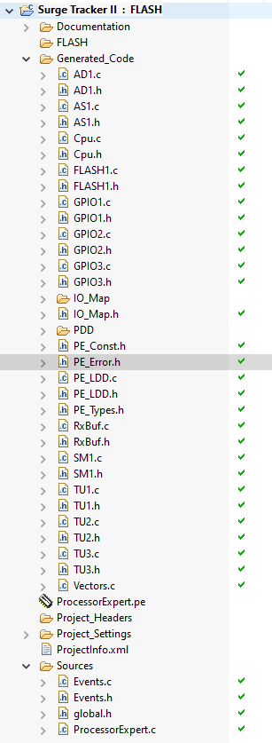

I am trying to save datas in flash data emplacement using fonctions generated by the tool (I am using codewarrior). It works fine for the first save but I can not erase et rewrite while I do not reflash the microcontroller. Is there a way to rewrite without reflashing systematically ?

I do not know the state of global interrupts. There are no trace of any kind of interrupt settings in the whole program.
It seems like it is drived directly into functions I refered to such as

Maybe, I did not understood your questions ? If I do, please tell me I will try to find something else which can match.
Thanks for your help.

TCazala
Hi @ErichStyger ,
I am trying to use your solution in my project but I have some type issues like.
Did you encountered something like "illegal implicit conversion from int to void*" when you were using NVMC_GetSumoData() ?
I also had troubles whith "uintX_t", did it happened to you as well ?

TCazala
Hi @myke_predko,
I am using Codewarrior for MCU version 11.1. I were contrained to use this API because I heritated this project from one of my collegue that can not support me on those issues ...
The code I sent you was directly in the project my collegue gave to me and in the heading, it is written that was "generated by the tool".
Moreover, in the description, lower in heading, there is a settings list where is this line : "Interrupt service : Disabled". I assume that iterrupts are already disabled when calling functions from this library.
It seems like I do not have any functions to enable/disable interrupts or I can not find which are they... Based to overs questions on forums it should be define in ProcessorExpert but there are not any trace of those.
Should I try to define it by myself, following your code ?
Here is the Project explorer, maybe it can be more usefull to understand my problem...
Thanks for your help !
