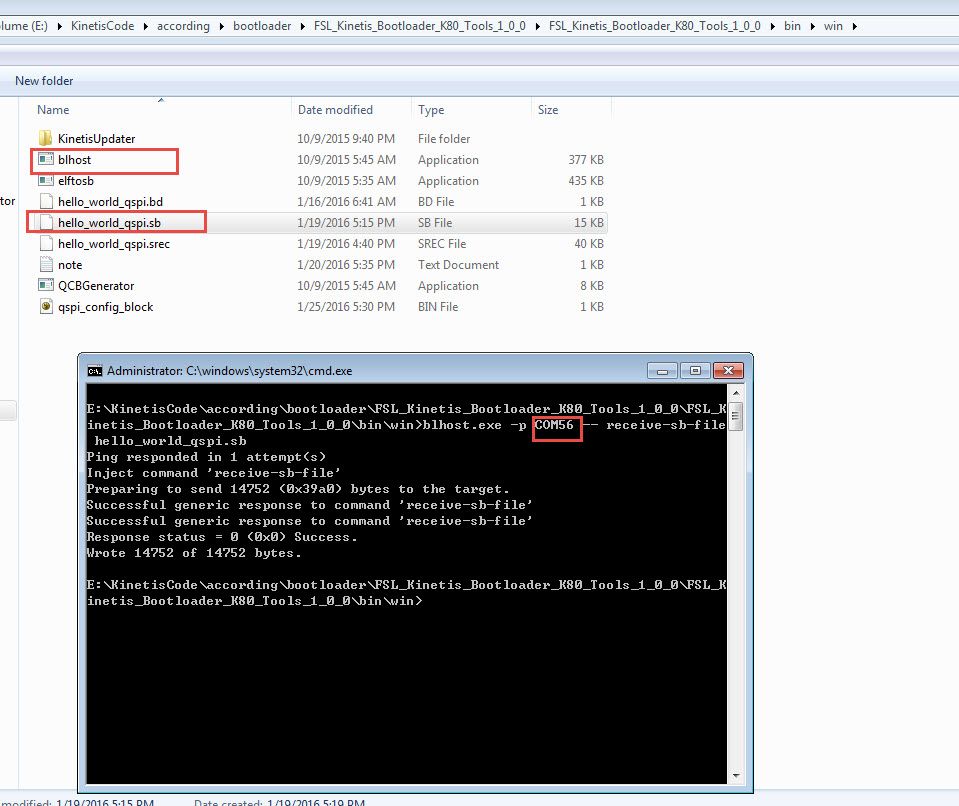

    Besides, take care, you should put the file hello_world_qspi.sb in the folder:\FSL_Kinetis_Bootloader_K80_Tools_1_0_0\bin\win, just like the following picture:
I also attached my hello_world_qspi.sb for your reference.
Wish it helps you!
If you still have question, please contact me!
Jingjing
