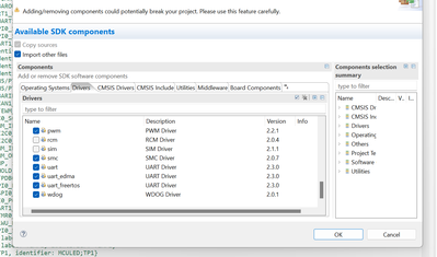

XBARA is not included in the SDK for MKV44. There is a similar post here:
Solved: Re: MKV44 SDK 2.8.0 missing XBARA Driver - NXP Community
Could you please resolved this? You are definitely not expecting us to use the sdk for MKV46 on the MKV44 platform, are you?

I downloaded the 2.8.0 SDK for the MKV44F128xxx16 and I found the xbara drivers inside the following route …devices/MKV46F16/drivers.
Could you please give it a try?
Best regards, Daniel.

Thanks, I found it and I have copied it into the project directory:
From ... C:\Users\"myusername"\mcuxpresso\02\SDKPackages\SDK_2_8_0_MKV46F128xxx16\devices\MKV46F16\drivers
to ...
C:\..\ProjectDirectory\drivers
Thanks a million. I hope there will be a release of possibly new version with Xbara included within the MCUXpresso IDE's SDK management interface.

Thanks for responding, Do you mean I should look some where in Windows Explorer? (This is the first product based around MCUXpresso platform and all I see is this interface where you right click and then go manage SDK... This is where XBARA is missing from).
