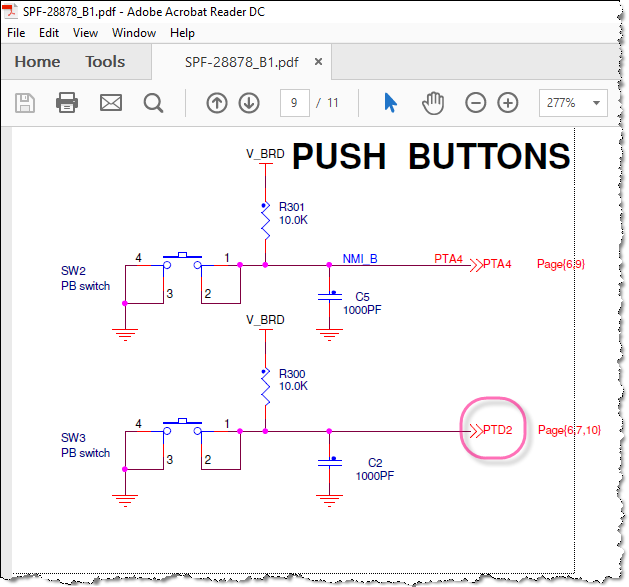

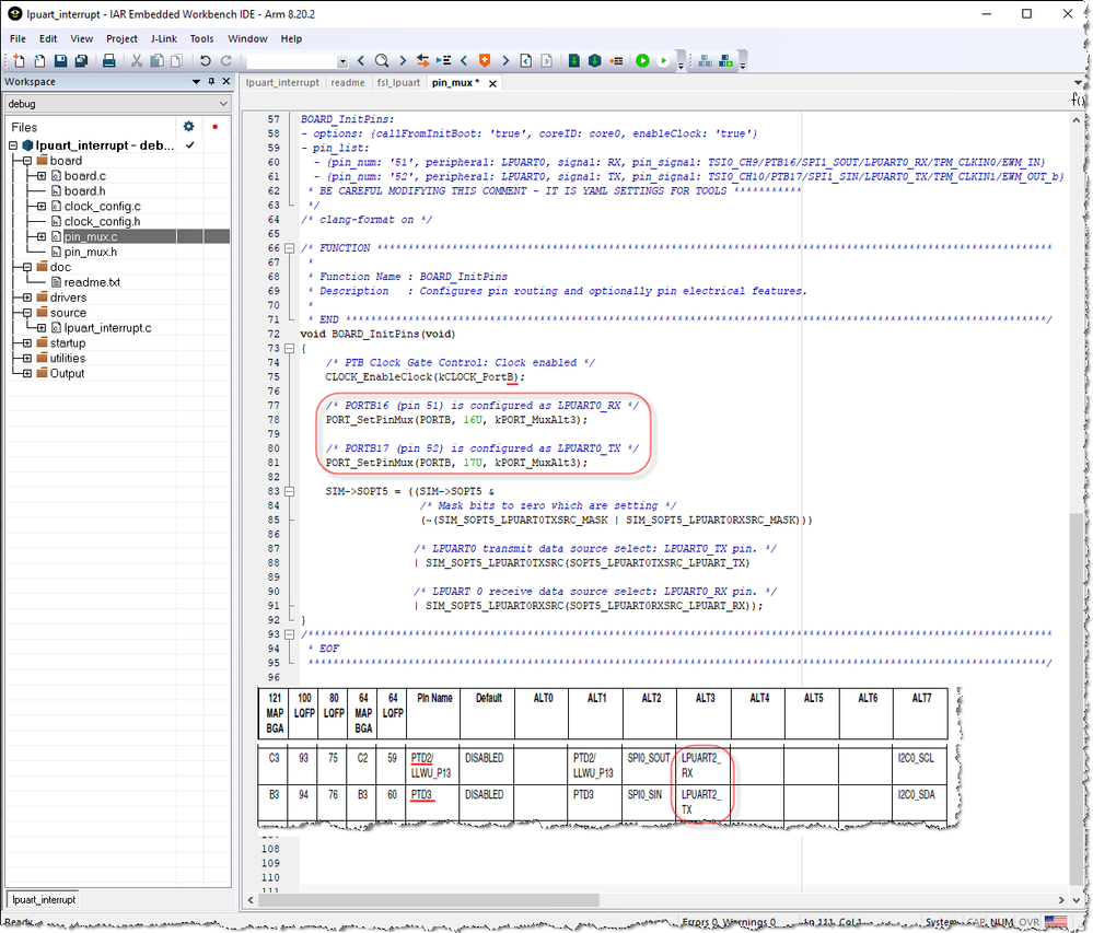

Have you try to configure PTD2 and PTD3 as LPUART2 function and enable the clock gate of Port D?
If you are using TWR-KL82Z72M or FRDM-KL82Z, the PTD2 is used for other function by default. You should notice the hardware circuit.
