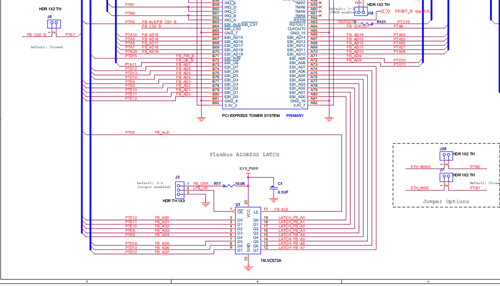

I've actually had some time recently to poke at my TWR-K53 board and I've notice a few things.
  1. I have loaded essentially a blank project to the board and I still get continuity between FB_AD[0] -> FB_AD8(Pins 80-73 on the Primary Elevator).
  2. After this I figured I should find a way to test this without the TWR-ELV in the mix so I took them off and I started probing points directly on the board with the power still on.
    1. I first wanted to test if the 5v and 3v3 supplies were good. I used TP2 for the 5v, TP11 for the GND and TP7 for the 3v3 check. They all seems to register at correct supply values. So that seems good at least.
    2. Next i moved onto the Flexbus lines. I tested the lines directly at the Flexbus Address Latch(U1 in the image below). It turns out that if I probe the LATCH_FB[0] to LATCH_FB[7] , they are all connected but the MCU side of the latch is totally fine.
    3. Does this mean that my address latch is probably blown and I need to replace it? I looked into the data sheet and I can't find a situation where all of the outputs would be connected. Suggestions?TWR-K53 Latch.png

if the lines are shorted together there must be something wrong.
You don't need the latch in your circuit so you could just remove it and connect the inputs to the outputs if you are certain that there is a problem with the chip.
