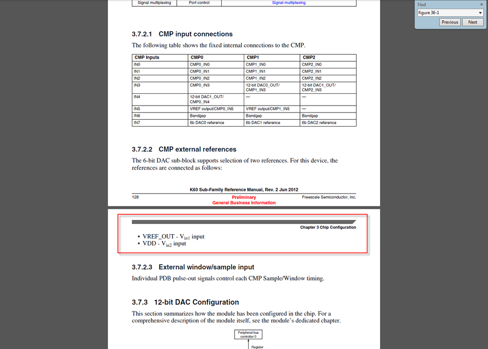

Good morning
I read on the Figure 36-1 of the RM for the K60 the two comparator's input selectable through VRSEL are Vin1 and Vin2.
In my understanding should be somewhere in the pinout of the uC. I don't find.
Maybe there is a good reason why are not there....
Thank You

Hi Pietro,
There is more info regarding Vin1 and Vin2 in Chapter 3, please kindly refer to the following for details.
Hope that helps,
Kan

Yes
Thank You
