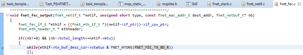

For me it looks like it hangs here:
9,874 Views
ChrisTango
It's the same on my side.
9,874 Views
dave408
Senior Contributor II
I'm not sure what to do next, but it could be a hardware configuration problem like you've said.  The fact that it's tight looping on a volatile means that elsewhere that status is supposed to be getting set, but it isn't.  Have you gone through all of the FNET enet init code to make sure all of the pins are configured properly?  Is there a doc somewhere that outlines what FNET API calls need to be made, and in which order before trying to send data?

mjbcswitzerland
Specialist V
1. Check that the buffer descriptor status values are all initialised to 0 when they are constructed during initialisation. This means that they are not owned by the Ethernet controller and can be used for new Tx frames.
2. Check how many such buffer descriptors are availabe - at least 2 should be used but often more are present.
3. The first usage of a tx buffer descriptor should work since they are all free (initialisation 1) but are the frames being sent out? If they are not they will fill up and then block further usage.
4. Check that the code includes erratas - the Tx can fail to start if the erratas are not respected. This is usually seen as delayed transmissions rather than blocking but could fail if only one buffer descriptor is used.
5. If the TX blocks with the ready bit set check the content of all of the buffer descriptors since they must all have blocked. In particular, check the length field set in the Tx buffer descriptors because if a length of 0 is set anywhere (which would be an error elsewhere) the Tx will never clear the buffer descriptor and they will effectively stall.
6. It may be best to have a short timeout in the wait loop, with an error return, since it is best to drop a transmission rather than lock up the board. This wait would normally be very short, even in heavily loaded networks.
Mark

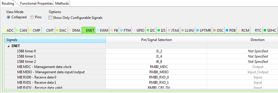

The only thing I see so far that might be wrong is that since you're using PEx to initialize peripherals, you need to map the ENET pins via your Pins1 component:
That said, after adding that, I still ended up in the hard fault handler.  I have been trying to diagnose it with Erich Styger's assembly code approach, but now I get this:

FYI to others, even though PEx is involved in this project, you do *not* need to configure the ENET pins in the Pins component.  As I debugged the hardfault on my end some more, I found that the hard fault is triggered when PCR17 is set, and then it was clear that FNET handles the enet pin configuration for you.  :smileyhappy:
