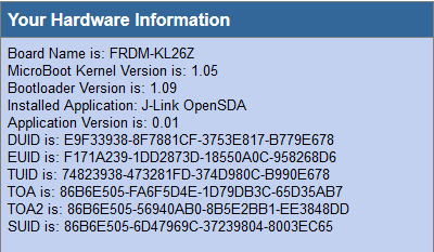

I'm trying to install the PE Micro OpenSDA debugger (MSD-DEBUG-FRDM-KL26Z_Pemicro_v114.SDA) on my KL26Z brd but no luck.
Previously, I had the J-Link OpenSDA debugger installed and now it is not updating... I still see the J-Link Debug on the Device Manager. Any clue?

So your board shows still the Segger firmware installed on it. I think you might have missed a step, or not followed closely the instructions to update the firmware.
This article might help you: Illustrated Step-by-Step Instructions: Updating the Freescale Freedom Board Firmware | MCU on Eclips...

In fact, when I extracted the BOOTUPDATEAPP_Pemicro_v111.SDA, this must have been corrupted or something strange happened to it.
I had to download it again. All working good and thanks again for your response.
