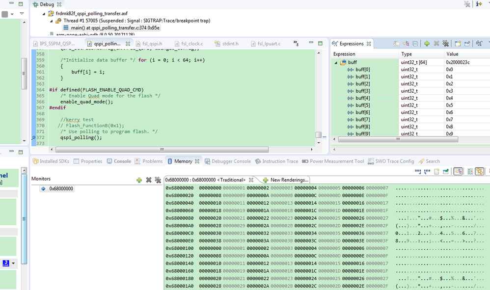

The MCU reference manual states that the default endianness for the QSPI peripheral is 64-bit little-endian.   However, with the QSPI peripheral configured for 64-bit little-endian, a core hard-fault condition ensues when attempting to execute code in sections located in external QSPI flash.  But the code runs perfectly with 32-bit little-endian configured.
I doubt that this is the correct behavior.  Any ideas?
PS. I need to add that there is no bootloader.  The flash is programmed directly, using J-Link.

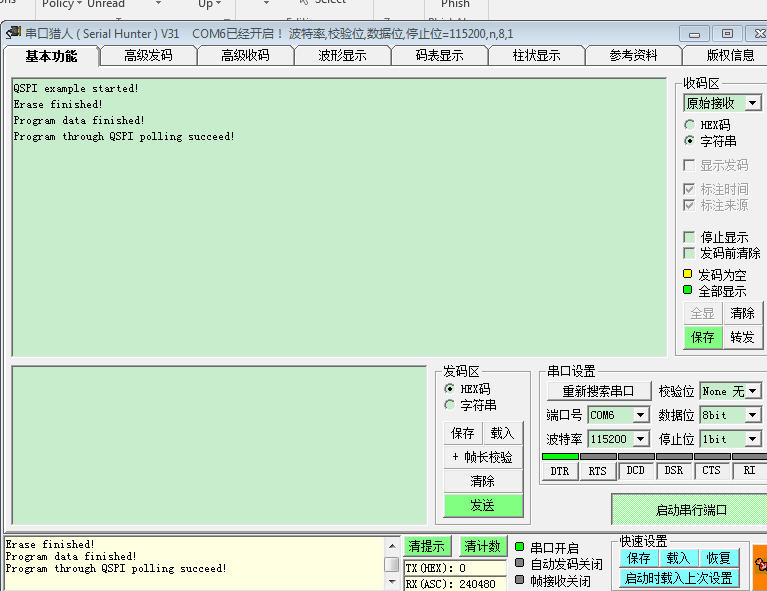

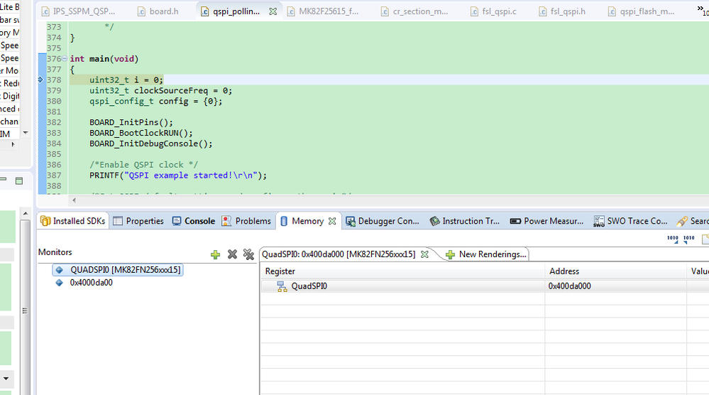

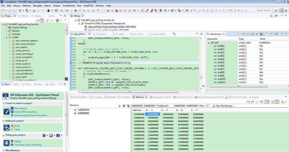

kerryzhou
Hi Denis,
   This week, I and my colleague work together on your issue.

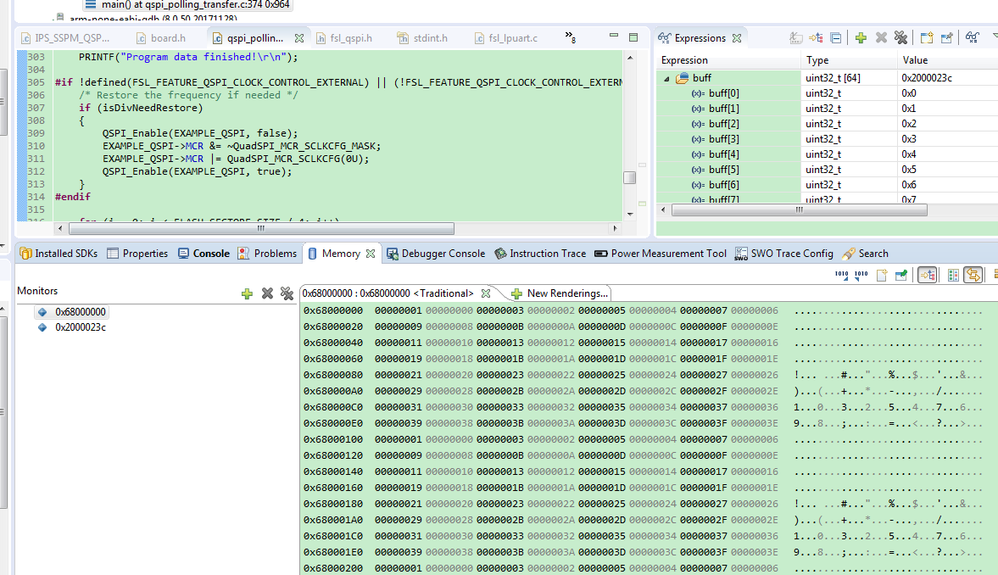

   Now, we find these information may useful to you:
1. About the 64LE can't work, and 32LE can work problem.
   If you do the QSPI flash erase at first, you will find, your 32LE can program the Flash_FunctionB to the according QSPI flash correctly with JLINK and MCUXpresso IDE, but 64LE can't program that function to your external flash. When test it, please make sure you erase the according flash sector at first.
  My colleague looked at the QuadSPI registers at the start of main. At this point they have been configured by the J-Link flashloader, and he found that the END_CFG value is set to 0x1 (32LE). This means, the JLINK driver already use the 32LE, it doesn't use the 64 LE, that's why the SDK code with 64 LE can't program the function to the external qspi flash directly. The phenomena is enter hardfault, because the according code even didn't write correct to the external flash if you erase it at first. Even you didn't erase it, the code which has been write to the external flash is the 32LE format, you use the 64LE to read the according code will have problems, can't recognize it, so it enter hardfault.
The mismatch between the endianness configuration between the flash driver and the SDK example are the root cause of the problem.
2.  32LE swap problem.
The simplest fix is probably to swap the buffer data before programming it in the sample code.The SDK/application buffer handling is easier to implement because the source code for the SDK is available.
We think, the segger driver also need to make the change.
My colleague will contact segger about this problem, but we think to get it prioritized, you also can contact Segger.
The above are our this week's summarize for your question.
Thanks a lot for your patience.
Kerry

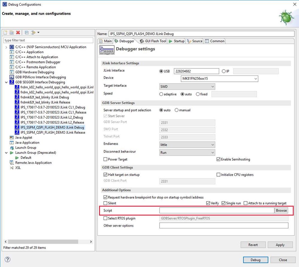

deniscollis
Contributor V
There is a scripting mechanism for J-Link that is supported by Eclipse/MCUXpresso.  Is it possible that all that is needed is a J-Link script that sets the QSPI Endian bits in the QuadSPI0->MCR register?
10,245 Views

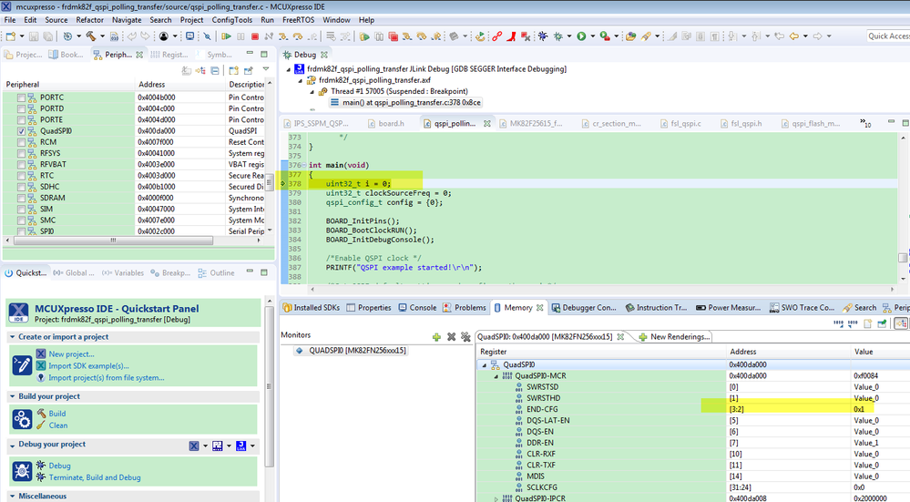

Contributor V

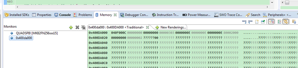

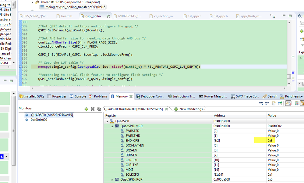

I wrote a JLink Script, which I triggered from the debugger, as above, which sets the endian bits in the MCR register directly before programming the flash.  However, this has no effect because, when I check the MCR register beforehand, it is set to 0xFFFFFFFF.  In other words, directly after the J-Link resets the target, the endian bits are already set to 64LE.
But, if I dump the MCR register as execution starts -- a breakpoint at the first statement in main() -- I see the MCR register has now been changed to 0x000F0084 (32LE).  This is before QSPI has been initialized.
Question: What happens between MCU Reset and QSPI_Init() that changes the MCR register?

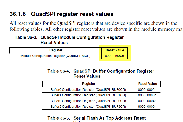

kerryzhou
Hi Denis Collis,
   About the JLINK script, I also search it in the IDE, but I didn't find it.
   I think this already contains in the JLINK driver, take an example, if you don't use the IDE download the code, just use the JLINK driver software, you also can't find the low level JLINK driver code or script.

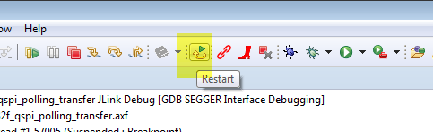

  About the MCU reset relationship with QSPI_INIT, do you find this character? If you download the code, the first time, enter the main, you can find it is 32LE:
But, if you use the software to reset the chip in the IDE:
This time, you can't see the register data,
even you check the MCR address, you also can't see it.
But if you run the initialize code:
So, after reset, the MCR is:
So, the first time enter the debug mode, the QSPI should be initialized by the JLINK driver, that's why you read out it as 32LE in main.But if you reset it again, all the data will be return back, you need to initialize the qspi with the code again.
Wish it helps you!
Do you contact with the SEGGER? If you get the reply, please kindly let me know.
Kerry

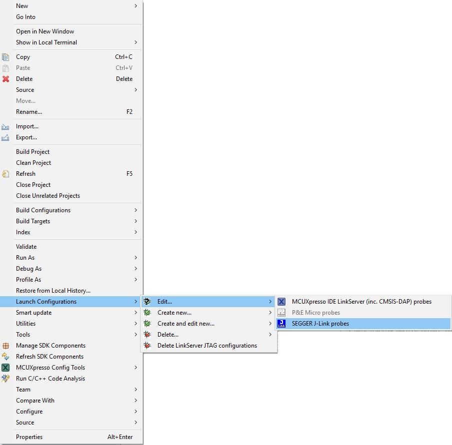

deniscollis
Contributor V
Hi Kerry,
Here's how to insert a J-Link Script:
File    : NXP_MK8x_QSPI.JLinkScript
Purpose : J-Link target setup file for NXP K81 and K82 QSPI XiP
Author  : Denis Collis, IPS Group Inc.
---------------------------END-OF-HEADER------------------------------
*       InitTarget
//int HandleBeforeFlashProg(void) {
int AfterResetTarget(void) {
     U32 U32_DATA;
     int r;
    JLINK_SYS_Report("J-Link script: NXP_MK8x_QSPI.JLinkScript");
     JLINK_SYS_Report("J-Link script: Halting target");
     JLINK_TARGET_Halt();
     U32_DATA = JLINK_MEM_ReadU32(0x400DA000); // 0x400DA000 = Address of QuadSPI0_MCR Register on K8x MCU
    JLINK_SYS_Report1("J-Link script: Reading QSPI->MCR: ", U32_DATA);
     U32_DATA |= 0x0000000C; // 0x0000000C is 64LE mask
    JLINK_SYS_Report1("J-Link script: Writing QSPI->MCR: ", U32_DATA);
     r = JLINK_MEM_WriteU32(0x400DA000, U32_DATA);
     if (r <0) {
          JLINK_SYS_Report("J-Link script: !!Unable to set QuadSPI_MCR to 64bit Little-endian!!");
     else {
          JLINK_SYS_Report("J-Link script: QuadSPI_MCR set to 64bit Little-endian");
     JLINK_SYS_Report("J-Link script: Resetting target");
     JLINK_TIF_ActivateTargetReset();
     JLINK_TIF_ReleaseTargetReset();
     return r;
10,245 Views

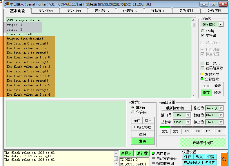

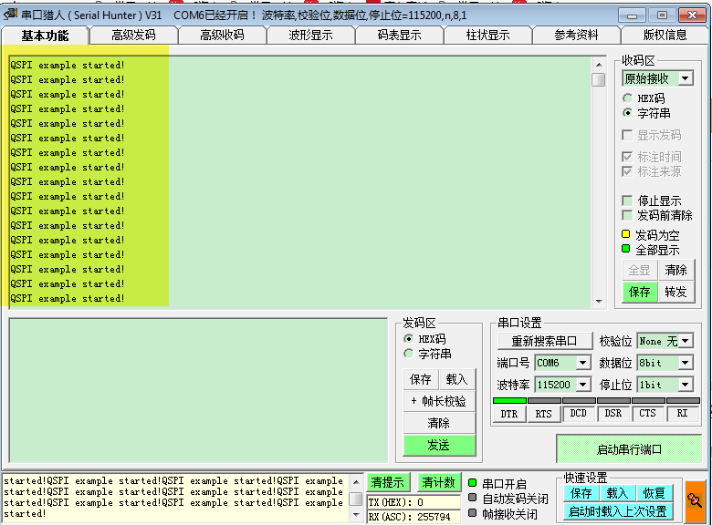

kerryzhou
Hi Denis,
   Today, I use the FRDM-K82 chip test your project, and our own SDK project, I meet the same problem as you.
   1. kQSPI_64LittleEndian
   If define a user function in the QSPI flash area or the according aliased area from 0X0400_0000-0X07FF_FFF.
   Don't call that function in debug mode, it's no problem, the according address also have the function data, but if call it in the main, I will meet the reset problem. I relocate the function to aliased area, just to make sure the code can be debugged. Because Debug access is available only in the aliased QuadSPI memory region.
  64 bit LE write have no problem, no 32bit word-pairs transposed problem.
Printf result also can find the write data is the same as read.
But after calling the function located in 0x68020000:
__TEXT(Flash3) //Flash3 //Flash5
int Flash_FunctionB(int myvar)
    PRINTF("output: %d\n", myvar);
    myvar++;
    return myvar;
 Flash_FunctionB(0x1);
The code will reset, this is the printf result:

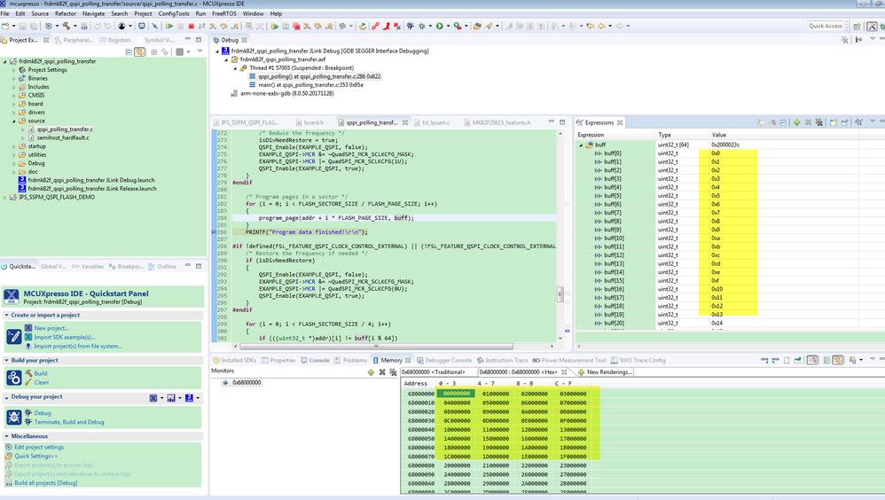

   2.kQSPI_32LittleEndian
    The same result as you.
    Call the function located no matter in QSPI area or the aliased area, no reset or hardfault problem.
   But after the write, the result really have the 32bit word-pairs transposed problem.pastedImage_2.png
This is the printf result with 32bitLE:
Function Flash_FunctionB located in 0x68020000, can be called, and works OK.
But the read out data is not the same as the write data. It is really have 32bit swapped  problem.
So, now I can reproduce your problem on my side, but I still need more time to find the detail problem.
Please give me more time,any updated information on my side, will let you know.

Just adding this from my tech support request, which may help others understand the problem:
  1. Hardware: K81 MCU part, and QSPI Flash part (either Micron MT25QL128 or Cypress S25FL128S)
  2. External flash is used for both XiP code, and raw data (file system).
  3. Parts are programmed from MCUXpresso via Segger J-Link.
  4. Data writes to flash are via Peripheral Bus Tx FIFO
  5. Data reads from flash are memory-mapped via AHBus
  6. 64-bit Little-Endian is default for QSPI peripheral on K81
With QSPI0->MCR |= kQSPI_64LittleEndian << 2 :
Data writes and reads match, but code execution ends in core hard fault.
With QSPI0->MCR |= kQSPI_32LittleEndian << 2 :
Code execution succeeds, but data writes and reads have 32bit word-pairs transposed.
10,245 Views

deniscollis
Contributor V
I have just seen that, even if execution succeeds, you could encounter unexpected results with QSPI0->MCR |= kQSPI_32LittleEndian << 2  --- For example, a register read from the external part returns a word-swapped result.
Clearly, 64-Bit Little-Endian is correct for this MCU.  I need to figure out why the executable code is word-swapped, or perhaps the word-order was swapped when the J-Link wrote the code to the external flash?
