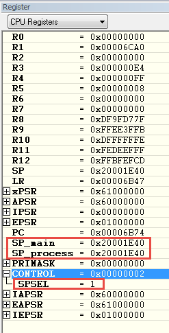

Below is KL25 MQX_Lite example CPU register info after MQX_Lite RTOS boot up:
And you could find below stack switch code at <boot.s> file, the SP_main and SP_process using the same SRAM address:

I reconfirmed the fact on my FRDM-KL25Z board. I have found SPSEL bit had been set to "1".
That is, we can modify CONTROL.SPSEL bit.
It is inconsistent with your comment. Did I misunderstand your comments?
