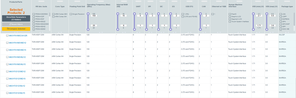

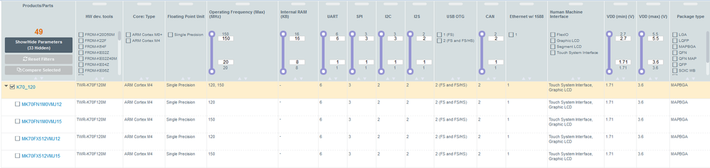

We are planning to select either K61 and K70 microcontroller for our next design and would want to know the major differences between the two or the differences worth considering. We are looking at the 256-pin BGA package for both.
I went through the documentation and Kinetis MCU Selection guide quickly to find that K70 additionally has a Graphic LCD controller. Apart from this, I was not able to see any major differences between the two. Both K61 and K70 have DDR memory controller in their 256-pin BGA packages, and we want to use it in our design. Specifically to DDR controller, is there any difference between the DDR controller of K61 and that of K70?
Any help would be much appreciated.
Kaitav
2,244 Views
ivadorazinova
Hi Kaitav Sapre,
DDR controller specifications are absolutely identical.
I checked the both datasheets http://cache.freescale.com/files/microcontrollers/doc/data_sheet/K61P256M120SF3.pdf and http://cache.freescale.com/files/microcontrollers/doc/data_sheet/K70P256M120SF3.pdf?fasp=1&WT_TYPE=D...
and the only difference between these both MCUs is the Graphic LCD controller for K70.
I´m also attaching you for your summarize both of them :
