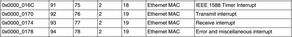

hi,
    The Ethernet works fine in k60 ,But now we replaced k60 with k66, the same code is not  working in k66 the interrupts are also not occurring , Any changes we needs to do for initialization part

I had changed the interrupt values also , iam I had used the wireshark  to receive the Ethernet packet for k60 board ,even thought the Ethernet in k66 is not working

Iam using keil5, We are giving external clock on EXTAL( pin.no 72) for both phy(lan8710 in RMII mode) and processor but we are not getting any interrupts .

jeremyzhou
Hi maheshwar reddy,
Thanks for your reply.
I'd like to know whether you had already used the Wireshark to capture the packet or not.
After compare the captured the packet, we can figure out the difference of ethernet application between the K60 and the K60.
And I think I miss one thing, the ethernet related interrupt vectors are different between the K60 and K66.
                                                                                    Fig K60
                                                                                        Fig K66
Hope it helps.
Ping
