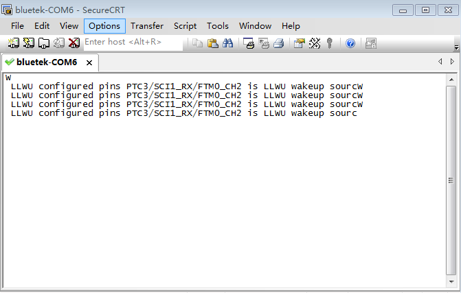

I'm working with KL25 on freedom board.I have a question about LLWU module and enter-exit from LLS mode.
I have written 3 projects to weakup my mcu from lls mode.I tried with the TSI ,LPTMR and the external pin ,using them as the source of LLWU.But the outcom is the same.Every time,when the interrupt happened ,the MCU will reset.
Here is the simplest one.Using the extern pin as the source of LLWU:

Here is the outcome:
whenever  I press the button.The mcu will reset,send a 'w' to the uart1 and print the information of llwu init. I don't know why.Could anybody help me?I am really anxious.

Seems you didn't disable the clock monitor before enter LLS mode, please try the following code instead.
void LLWU_Init(void)
    clk_monitor_0(OFF);
    enable_irq(LLWU_irq_no);
    llwu_configure(0x0080, 0x02, 0x00);    // External input enabled as falling edge detection
I also attached my test project here.
Press any key to enter lls , and pull PTC3 down would wake up the device:

stephenkung
thank you very much for your answer.I have tried with your code,now it works correctly!
