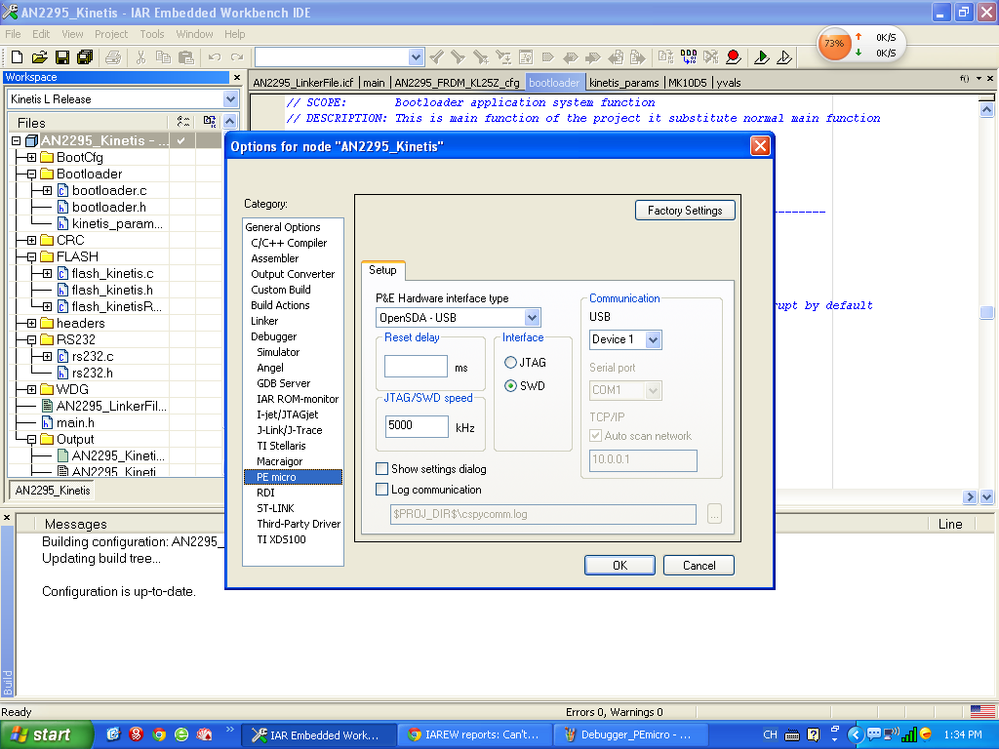

I am evaluating AN2295 serial bootloader on FRDM-KL25Z with IAREW650.

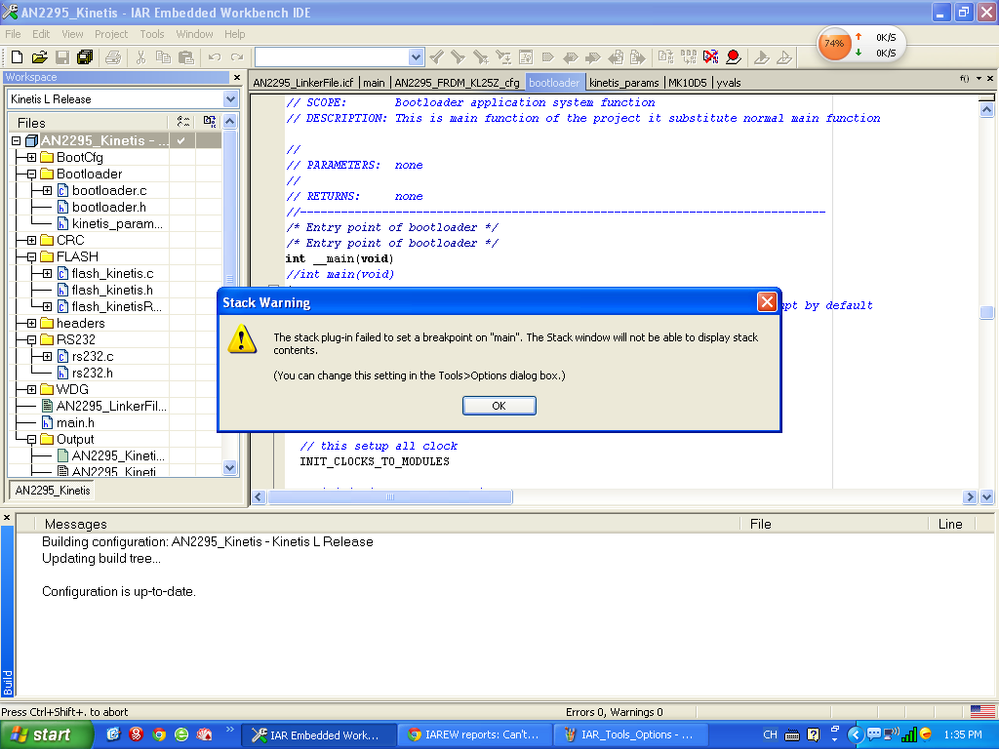

Before debugging, I change debugger to PEmicro - OpenSDA, nothing more. When I start to debug, the IAREW reports: Can't run to "main".
And it has no main(), it has only __main().
What else should I change to debug the AN2295 code?

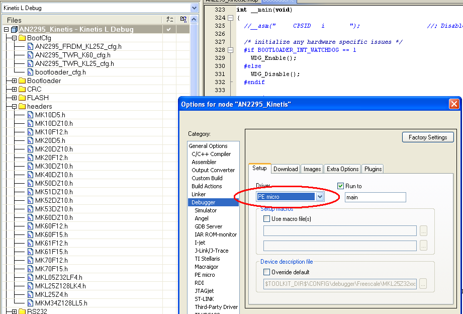

First, you have to set the correct debug interface , for example, like below:

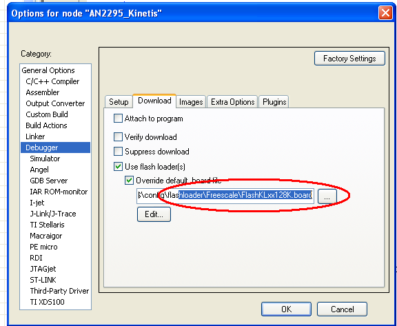

and you have to select the proper flash loader:
With the above settings, you may start to debug the AN2295 demo.

Change Debugger to PEmicro
Enable Debugger download options. (Very important, it seems the root cause)
Change P&E hardware interface to OSJtag to OpenSDA (it seems we don't need the patch, since EWARM 6.50 has  supported OpenSDA already).
Start debug session.
It reports same issue as well.

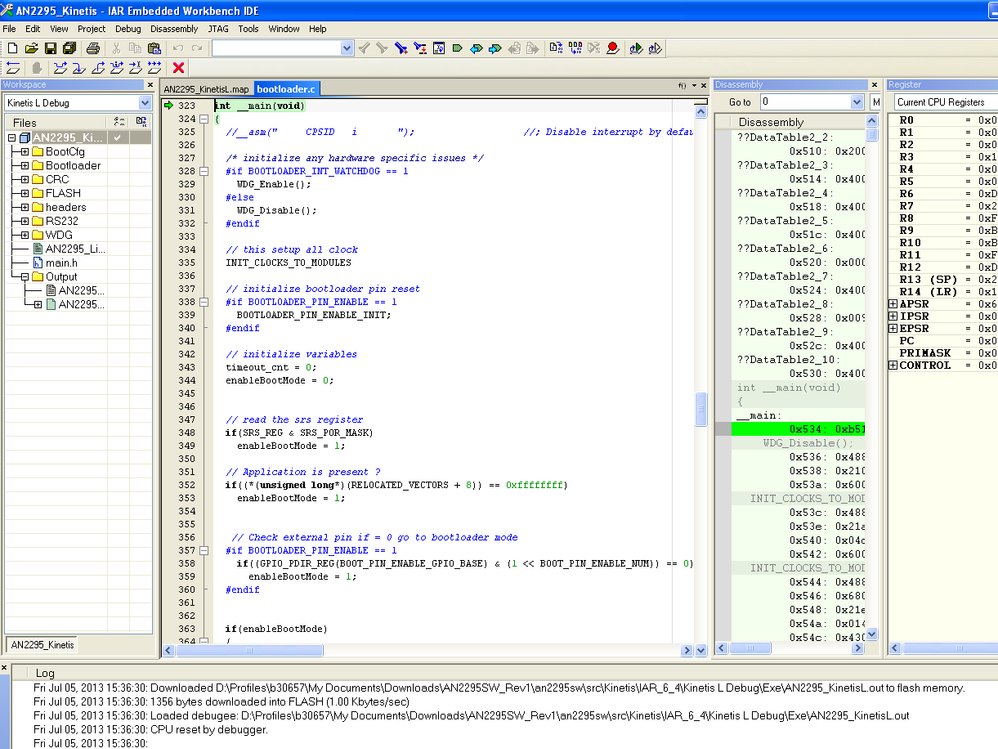

Then I changed run to main as run to '__main'.
No complaints.
When there is no user application in the flash memory, the bootloader seems always come back to __main. I will evaluate this operation with a simple user application.
