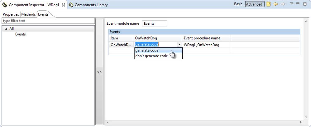

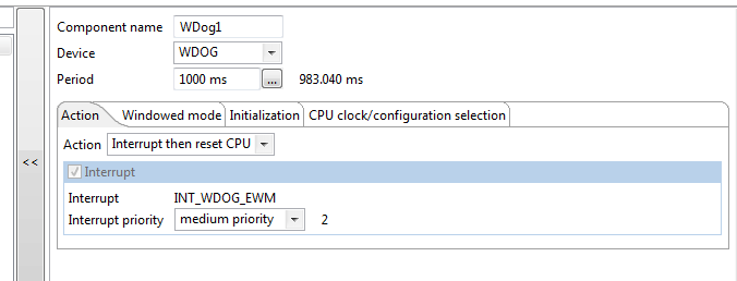

I'm not able to configure the Watchdog using PE on MKE02Z in order to interrupt and then Reset the CPU as shown:
After PE code generation INT_WDOG_EWM is not listed in vector table nor at Events.c.Before a WDG reset is performed I need to save some variables in a non volatile memory. How can I do this?

Once you select the Wdog component, you must go to Events tab and select "generate code" on OnWatchDog option in order to create the ISR entry that will be called once watchdog timeout occurs:
Then Save changes, generate code and ISR should appear on event.c file:
