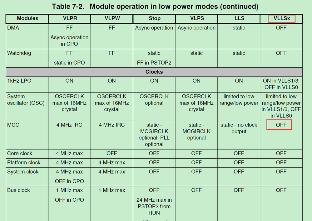

I checked the KL46 reference manual, below picture shows the MCG module is OFF during VLLSx clock mode.

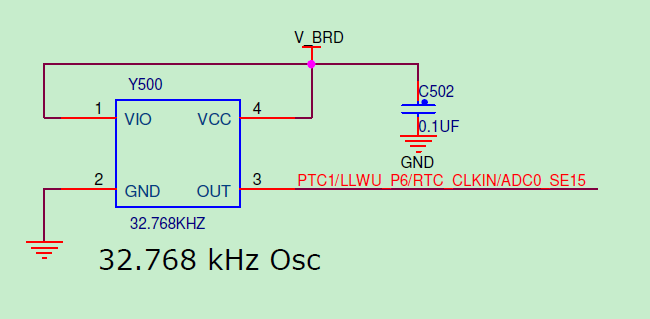

Customer could not using MCG IRC 32KHz clock as RTC module clock, the RTC module clock source with below option:
Customer need to use TWR-KL46Z48M to do the RTC wake up KL46 MCU from VLLS1 low power mode test, for the TWR-KL46Z48M board provides 32KHz oscillator connects with RTC_CLKIN pin.

yes in fact i use the LPO 1khz like clock source for the RTC. You can see this in the fsl_clock_manager, clock configuration 2.

colin
If you are measuring the extra 23 seconds from real time (instead of from the RTC time on the MCU), it may be that the LPO 1 kHz clock's poor accuracy is to blame.  It is specified as 1 kHz +/- 10%, and 23 seconds in 5 minutes is about 8% error, so it's possible that is part of it.

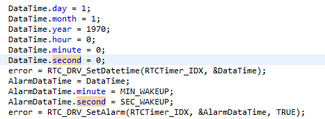

I checked your project, In <Wakeup.h> with below definition:
#define MIN_WAKEUP 5
#define SEC_WAKEUP 00
If that code be updated before you sent the code?

danielecortella
Contributor V
The firmware wake-up, reset the rtc in set_wakeup_timer and set the alarm after the MIN_WAKEUP (minutes) : SEC_WAKEUP (seconds). In the firmware sended the wakeup alarm is set after 5 minutes.
AlarmDataTime = DataTime; AlarmDataTime.minute = MIN_WAKEUP; AlarmDataTime.second = SEC_WAKEUP;
