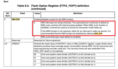

Celeste_Liu
Hello @nick_schneider ,
Thanks for your post.

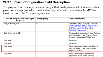

Have you modified the NMI_DIS bit in the FOPT register?  You need to set this bit to 0 to disable the control for the NMI function. Please refer to the screenshot from the RM below.
The data in the flash configuration field are copied to register automatically after Reset.
The data in 0x40D is copied to FOPT register.
Form software configuration, the SDK has the array. For MCUXPresso, its path is startup/startup_mkl16z.c:
Hope it can help you.

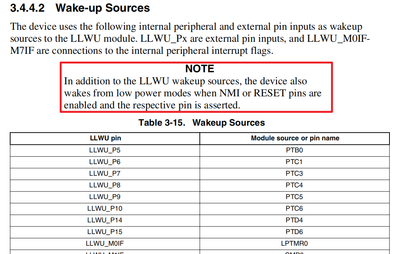

Celeste_Liu
In the RM, you can see the explanation: In addition to the LLWU wakeup sources, the device also wakes from low power modes when NMI or RESET pins are enabled and the respective pin is asserted.

4,600件の閲覧回数
nick_schneider
I do not believe that the NMI is the wakeup source in this situation. The NMI never activates on its own. The NMI will only activate after a different LLWU is triggered during VLLSX. In my sample project for example, the wakeup is caused by the LPTMR at a consistent interval and then the NMI is triggered. Its almost as if the NMI pin that I want to use as a GPIO is reverting back to its default state as the NMI trigger and also activates an internal pullup. But that does not explain why I do not see the NMI at power-up.

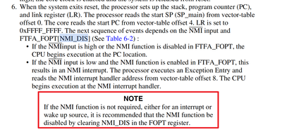

4,570件の閲覧回数
Celeste_Liu
NMI_PIN is special pin in KL series. If the NMI function is not required, either for an interrupt or
wake up source, it is recommended that the NMI function be disabled by clearing NMI_DIS in the FOPT register.
When the system exits reset, the processor sets up the stack, program counter (PC), and link register (LR). The processor reads the start SP (SP_main) from vector-table offset 0. The core reads the start PC from vector-table offset 4. LR is set to 0xFFFF_FFFF. The next sequence of events depends on the NMI input and FTFA_FOPT[NMI_DIS]:
• If the NMI input is high or the NMI function is disabled in FTFA_FOPT, the CPU begins execution at the PC location.
• If the NMI input is low and the NMI function is enabled in FTFA_FOPT, this results in an NMI interrupt. The processor executes an Exception Entry and reads the NMI interrupt handler address from vector-table offset 8. The CPU begins execution at the NMI interrupt handler.
4,640件の閲覧回数
nick_schneider
Thank you, it looks like this is the proper way to avoid a NMI during a VLLSx wake-up.
