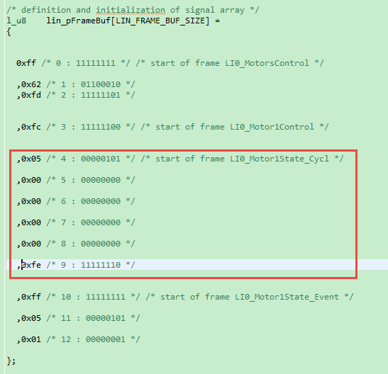

The LIN Stack for KEA product demo also provides how to response LIN Master.
The below function called in KEA64_LIN_Slave project will response LIN master with Motor1 Temperature.
l_u8_wr_LI0_Motor1Temp(Motor1_temp);
I had make some change with LIN Master schedule table just with [NormalTable]:
[Motor1Control] is LIN Master send to select motor1;
[Motor1State_Cycl] in LIN Slave send to response the motor1 state (6 bytes).
The 6 bytes located in lin_pFrameBuf[LIN_FRAME_BUF_SIZE] array at <lin_cfg.c> file:
The l_u8_wr_LI0_Motor1Temp(Motor1_temp); function will modify the [Motor1State_Cycl] related data range.

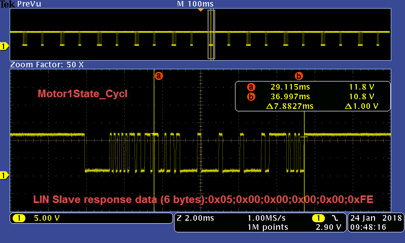

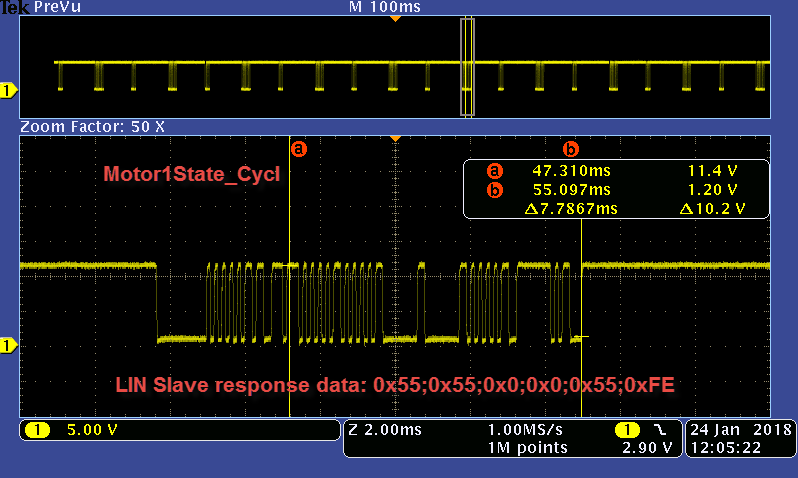

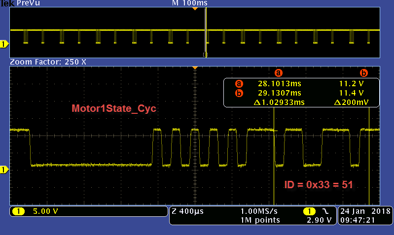

For my LIN bus analyzer tool with some issues, I use scope to capture the LIN bus signal and could find the LIN Slave response data to LIN master.
Please check below LIN Bus communication signals:
After I change the response data value, then I could get below LIN Slave response data changed.
Wish it helps.
