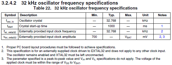

I see the Table 22 in Kinetis K27 data sheet.
It was written typ. 1000ms, but I couldn't find its starting point.
When is the starting point? After then POR/Reset or other timming?
Could you tell me its starting point?

Hi Masahiro,
You can find below information at RTC_CR[OSCE].
After setting this bit, wait the oscillator startup time before enabling the time counter to allow the 32.768 kHz clock time to stabilize.
