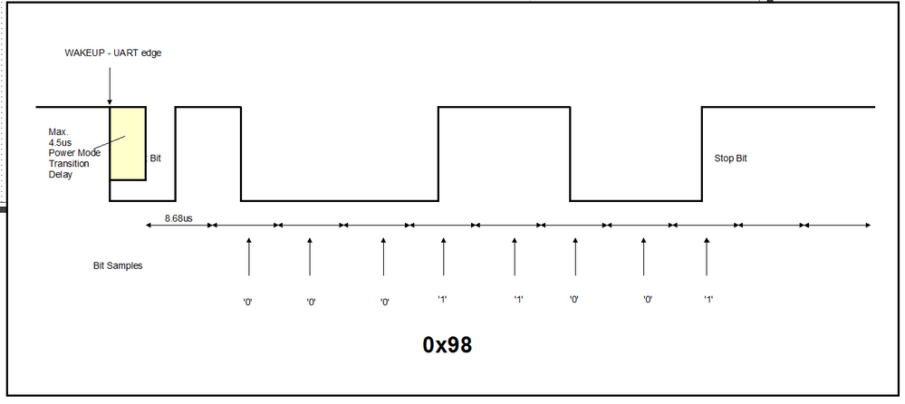

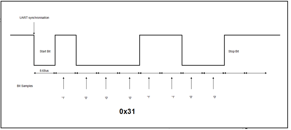

Hi All

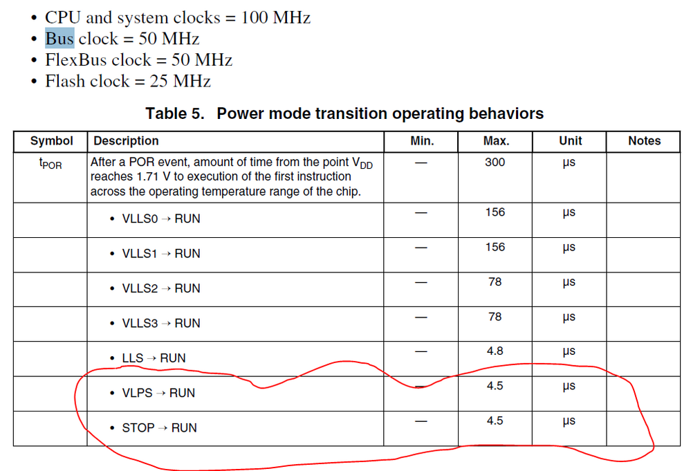

I have am update where it looks that 57600 Baud is the limiting case for the unrestricted operation in this exact mode. First the finding and reasoning is shown and then a workaround is suggestedif 115200Baud (or higher) are required.
During testing it was noticed that occasionalls the first reception character waking the processor would be corrupted. It is believed that thsi is due to the power transistion delay between the normal STOP or VLPS modes to the RUN mode. The reasoning for thsi believe is below, based on the fact that test characters of 0x31 always resulted in a bad character of 0x98,
  1. The first reason is that the data sheet specifies max. 4.5us for the power mode transition which would be about half a Baud period at 115kBaud, thus so putting the sampling pretty much on a data edge (sometimes it would be Ok but in the worst case it could sample bits with one bit delay). The data sheets show the worst case transition delay:data1.bmp
  2. The second reason is that I measured the corrupted character as the content of the correct one but shifted by 1 bit, which would confirm that the processor was indeed woken by the falling edge of the start bit but its bit synchronisation is up to 1 bit delayed. See the following for the effect of the delay that I believe is taking place:
Normal case
Worst case transition delay causes a single bit shift to give the error value that was also sometimes seen.
