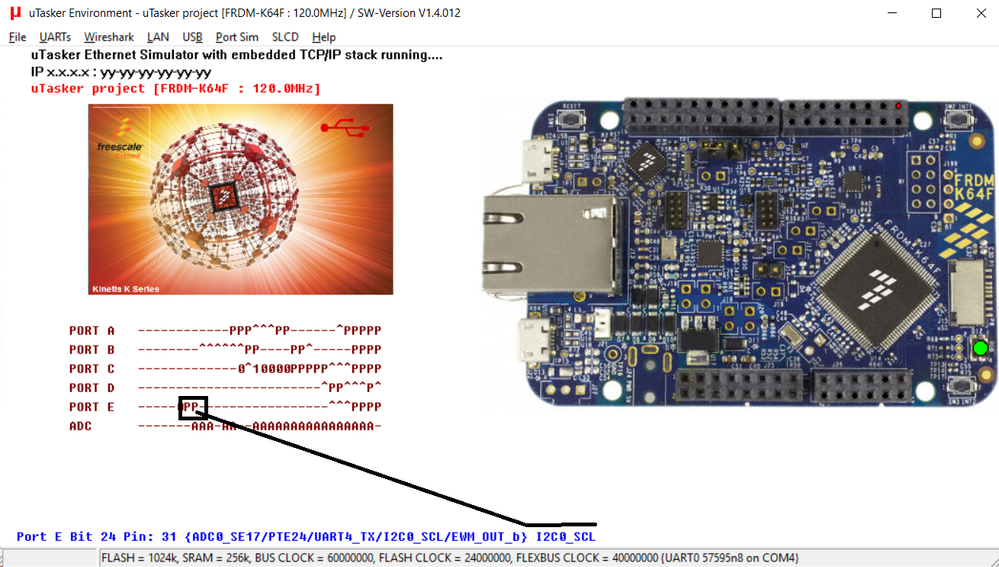

mjbcswitzerland
Specialist V
Andy
I think your code writes a buffer of data and reads a buffer of data but doesn't control the EEPROM's internal address. That means that (assuming after a power cycle) it will write to the page address 0, 1, 2,3,..n and then read back from the address n+1, n+2, n+3 etc. which will not read back the data that has been written (and the compare will fail).
This means that you need to control the internal address pointer (the first byte of the data sent when writing and also write it just before reading back again, as described in the EEPROM's data sheet).
The uTasker project includes support for the EEPROM that you are using (it also simulates it) and below is the reference code to write and read to/from page 3 (for example).

On first use it reads and display the first 16 bytes in the page, then write 0x05 to address 3, followed by 3,4,5,..0xa to a addresses 5..12.
After a power cycle the values written (to verify they are non-volatile) are shown to be there as expected.
A binary file to do this on the FRDM-K64F is attached, whereby the I2C connections are on PTE24 and PTE25 and the debug interface on OpenSDA COM at 115200Baud.
Mark
