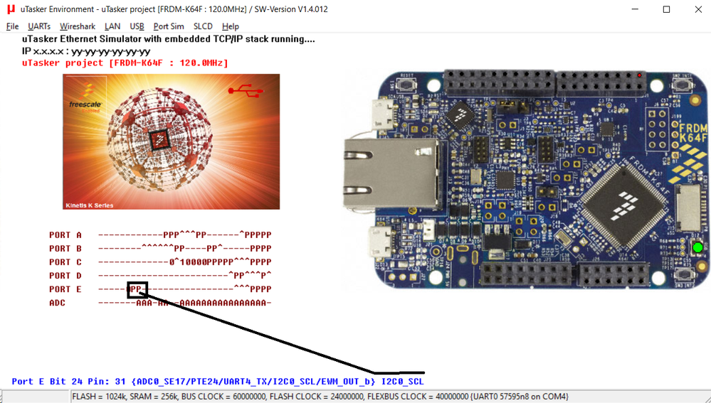

The uTasker project includes support for the EEPROM that you are using (it also simulates it) and below is the reference code to write and read to/from page 3 (for example).

On first use it reads and display the first 16 bytes in the page, then write 0x05 to address 3, followed by 3,4,5,..0xa to a addresses 5..12.
After a power cycle the values written (to verify they are non-volatile) are shown to be there as expected.
A binary file to do this on the FRDM-K64F is attached, whereby the I2C connections are on PTE24 and PTE25 and the debug interface on OpenSDA COM at 115200Baud.
