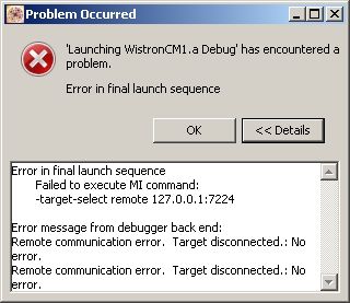

However when I come to debug the KL04 project the debugger objects with the message below:
Does anyone know if a KL04 based project can be debugged on a FRDM-KL05Z board?

You will need to modify your FRDM-KL05Z board (cutting/making traces).
See Debug External Processors with USBDM and Freedom Board | MCU on Eclipse
