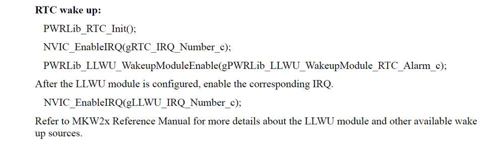

I'm having a hard time using the RTC Alarm as a wakeup source from VLLS0/1/2/3 on the K64 and  wondering if anyone here can be of help.
I'm setting bit 5 of the LLWU_ME to enable the RTC Alarm as a wakeup module. I can go into VLLS successfully but never leave and reset using RTC Alarm. The alarm I’m setting is just 30 seconds in the future. So I read the current time from RTC_TSR and increment it by 30. I'm able to use the LPTMR to wake up from VLLS1 but RTC Alarm never works from any of the VLLS levels. So the VLLS part is fine but having the RTC Alarm trigger a LLWU is not.
Here's some snippets of the relevant parts of the code. Any help would be greatly appreciated!

FYI, I was able to fix this by writing to clear the RTC Time Alarm flag inside the LLWU IRQ handler:
__sysfunc void LLWU_IRQHandler(void)
   RTC_SR |= RTC_SR_TAF_MASK;
I tried this after going through AN4503 and reading this: "Pin wake up flags must be cleared in the LLWU"

Hello
Use RTC Alarm as a wakeup module , the wakeupt flag is  LLWU_F3 - > MWUF5 .
and for the internal wakeup source caused the flag , it is cleared follow the internal peripheral flag clearing mechanism,
that it to say , clear the flag on  RTC interrupt function .
Hope it help

Hello ,
Yes , you are right , the RTC interrupt flag.
- Which VLLSx mode do you run, if VLLS0, In reference manual, the LPO is off , so you can not use LPO here :
  SIM_SOPT1 |= SIM_SOPT1_OSC32KSEL(3);
  You can change to “RTC 32.768KHZ oscillator” ot test , and the LPO is power on on VLLS1 VLLS2 VLLS3 mode , so you can test these mode .
-If it still can not work ,  you can set a breakpoint to check if RTC alarm interrupt happen.
- And i recommend you one DOC http://cache.freescale.com/files/rf_if/doc/app_note/AN4857.pdf ,
although the chip is different , while the procedure is the same :
Hope it helps
Alice
