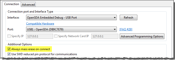

I'm afraid there is no EZPORT in Kinetis L devices, so you need to stick to the SWD mass erase.
SWD certainly supports mass erase command, but you are correct, I am not so sure about OpenSDA bridge, this would be a question for P&E.
About CodeWarrior, the Flash Programmer tool should send a mass erase command, or even the debug configurations with P&E connections have an option to mass erase before programming. You may try to program a new empty application and select that option. Check this:
Also, I found the appnote at the next link suggesting to hold the reset line while mass erasing via SWD. I recommend you to read chapter 4 (especially 4.1.1, 4.2, 4.2.1 and 4.2.1.1):
http://cache.freescale.com/files/microcontrollers/doc/app_note/AN4835.pdf

However, I think you should still be able to mass erase the device with a SWD tool. AFAIK the mass erase restriction is just for the "Erase All Blocks" Flash command, which is implemented by code. Did you tried a mass-erase and it did not work?. In case you did, I guess the only option is a J-link with "Unlock Kinetis" command or a mass-erase script.

Simply selecting "Always mass erase on contact" and loading some code did the trick.
When I load a project to SRAM it also runs again too!!!
Thanks a million - I didn't even need to do anything with the reset line.

This actually helps understanding that OpenSDA supports mass erase command. And also, I will try later, but seems that the Flash Programming Utility does not serve to mass-erase as I stated.

In fact I have seen that the "Connection" selected when using the "Flash File To target" in the Flash Utility is the same one as used to download project code and thus has the option "Always mass erase on connect". This means that it would supposedly be possible to do the same using this and commanding "Erase Whole Device".
