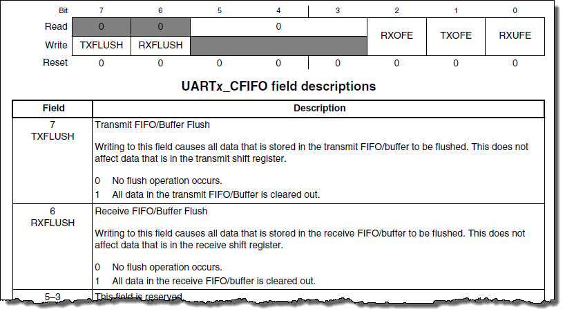

I am Using K60, I am trying to communicate with a GPS using some AT commands. The input coming from the GPS is of 79 bits including CRC, LF,CR bits. So I declared the buffer size to char receive_buff[79]. So while receiving 79 bits its giving the complete value, but in case when GPS signal is not present the data being received from the GPS varies from 40 bits to 65 bits and is random.
So in this case the values is not displayed until the buffer is full by the next data.
My concern is I want to display the coming data no matter if the data is on full signal strength or low signal. so How do i operate with half filled buffer?
also, If I want to flush the data of the buffer , how do I do it?
Is there any way to insert '\0' to the remaining bits of the buffer which is larger than data received?  As per the datasheet, the bufffer should be filled according to  the size of UART buffer declared initially otherwise 2 data will be added and the result will be displayed skipping the accordingly. Please look into the matter

Hi Jorge
I meant that until the RX buffer is filled completely we cant extract data from that. and that gets filled when the next data comes from the GPS.  and Yes Jorge i mistakenly wrote bits it is supposed to be bytes. Ok I will try your solution . Thanks

I think your GPS device will send the LF+CR even when the signal is low, right?
In this case I think the only solution would be polling the receive buffer to be aware of receiving that pair of bytes, or monitor the UARTx_S1[IDLE] flag, and then flush the input buffer. The Kinetis UART module allows you to flush the RX and TX buffers via the UARTx_CFIFO register, with TXFLUSH and RXFLUSH. Look at the next image:
Hope this is useful!

Hi Jorge
when the signal is low the value being received is
$GPRMC,,V,1303.7753,N,7735.09728,E,,,,,,M*6E<CR><LF>
when the signal is high the value is
$GPRMC,73859,A,1303.77271,N,7735.1103,E,0.1,200.4,170314,1.6,W,N*18<CR><LF>
So you can clearly see the values being received varies in size and in 1st case 2 data were being merged and displayed. I will try your solution and update you on the situation. I have one doubt also if I flush the rx data, then in 1st case since the data size le not 79 bits as declared so the rx buffer will again be inaccessible until it is completely filled upto 79 bits. So what should I do to extract the data from that buffer in this situation.?

Hi Amit:
... in 1st case 2 data were being merged and displayed ...
Sorry, I do not understand this part, what do you mean by 2 data merged?
I think you mean *bytes* here, correct? In this case you should extract the data before flushing the rx buffer. You could do this for example in the *idle line* interrupt.
