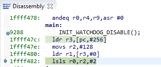

- being curious I couldn't resist looking into this some more and am getting the feeling that whatever I loaded to the board has really made the device unusable.
- If I load code to the SRAM I can read back the code normally. It is however impossible to run the code. Below I have copied a clip from the debugger screen showing that the disassemble window shows all good (code in SRAM from the address) - I also moved the PC to an instruction that doesn't use memory to ensure that it is purely internal. WHen executing a single step the hard fault exception is called (I think - since it jumps to an address that happens to be programmed at the Flash address 0x0000000c).
- When I load the same code to a KL25 board with no weird Flash configuration it has no problems and can step the code.
Is it possible that some configuration is not allowing instruction execution in SRAM? I didn't find any setting that would block core instruction accesses.
