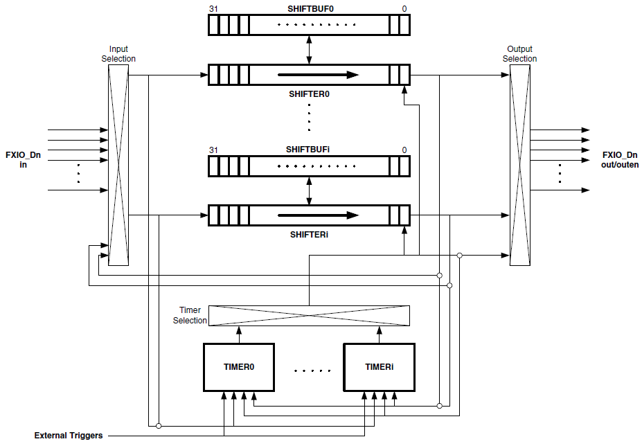

The FlexIO module was first introduced in the Freescale Kinetis KL43 family. It is capable of emulating various serial communication protocols including: UART, SPI and I2C. The FlexIO module is very flexible and you can configure it according to your communication needs. The main components of the FlexIO module are the shifters, timers, and pins. Data is loaded onto a shifter and a timer is assigned to generate the shifter clock and use a pin to output the data from the shifter.
The KL43 FlexIO module has 4 32-bit shifters, 4 16-bit timers and 8 bidirectional I/O pins. Each shifter and timer has its own configuration registers. The most important registers that configure the whole FlexIO behavior are the SHIFTCFG, SHIFTCTL, TIMCFG, TIMCTL and TIMCMP registers. There are other registers that contain status flags, interrupt enabling bits and the buffers for the shifters.
Shifters have a timer assigned to them to generate the shift clock and it can be configured to shift data in or out. When the shifter is configured to transmit mode, the data from the SHIFTBUF register will be loaded to the shifter and the shifter status flag will be set meaning that the shifter is ready to start the transmission. In receive mode, the shifter status flag is set when SHIFTBUF has been loaded with the data from the shifter, and the status flag is cleared when the SHITBUF register is read.
The timers are highly configurable, they can use external or internal triggers to generate certain conditions to reset, enable and disable the timer. The triggers can be a timer output, shifter status flag, pin input or an external trigger input. They can be configured to enable in response to a trigger, pin or shifter condition.
Each shifter or timer can be configured to use any FlexIO pin with either polarity. The pins can be used as an input or output. A pin configured as an input for a timer can be used to receive a clock and use it as the shifter clock that is assigned to this timer.
Once everything is configured you need to read/write the shifter buffers and the shifter and timer status flags to start a transmission or to read the contents of the shifter buffer when receiving data.
The following diagram gives a high-level overview of the configuration of FlexIO timers and shifters.
Figure 1. FlexIO block diagram

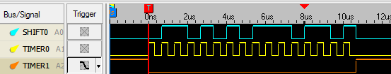

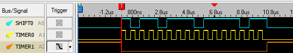

In the following example configuration, the FlexIO module will be configured as a transmitter. It will use one shifter, two timers, and three pins. The pins will be used for the outputs of the shifter and the two timers. One timer will be used as the shifter clock and the other timer will be used as a chip select to show when a transmission is being made. The FlexIO will be configured to have a baud rate of FlexIO clock/4 and will do an 8-bit transmission.
Figure 2. Example transmission
Timer 0
Timer Configuration 0 Register (FLEXIO_TIMCFG0) = 0x00002200
TIMOUT = 0    Timer output is logic one when enabled and is not affected by timer reset.
TIMDEC = 0    Decrement counter on FlexIO clock, Shift clock equals Timer output.
TIMRST = 0    Timer never reset.
TIMDIS = 2    Timer disabled on Timer compare.
TIMENA = 2    Timer enabled on Trigger high.
TSTOP  = 0    Stop bit is disabled.
TSTART = 0    Start bit disabled.
Timer Control 0 Register (FLEXIO_TIMCTL0) = 0x01C30101
TRGSEL = 1    Trigger select. Shifter 0 status flag.
TRGPOL = 1    Trigger active low.
TRGSRC = 1    Internal trigger selected.
PINCFG = 3    Timer pin output.
PINSEL = 1    Timer pin 1 select.
PINPOL = 0    Pin is active high.
TIMOD  = 1    Dual 8-bit counters baud/bit mode.
Timer Compare 0 Register (FLEXIO_TIMCMP0) = 0x00000F01
TIMCMP = 0x00000F01
Configure 8-bit transfer with a baud rate of FlexIO clock/4. Set TIMCMP[15:8] = (number of bits x 2) - 1. Set TIMCMP[7:0] = (baud rate divider / 2) - 1.
In our case we want an 8-bit transfer so TIMCMP[15:8] = 0xF and a baud rate divider of 4 so TIMCMP[7:0] = 0x1.
Timer 1
Timer Configuration 1 Register (FLEXIO_TIMCFG1) = 0x00001100
TIMDIS = 1    Timer disabled on Timer N-1 disable.
TIMENA = 1    Timer enabled on Timer N-1 enable.
Timer Control 1 Register (FLEXIO_TIMCTL1) = 0x00030283
TRGSEL = 0    Trigger select. Doesn’t matter because we won’t use a trigger.
TRGPOL = 0    Trigger active high.
TRGSRC = 0    External trigger selected.
PINSEL = 2    Timer pin 2 select.
PINPOL = 1    Pin is active low.
TIMOD  = 3    Single 16-bit counter mode.
Timer Compare 1 Register (FLEXIO_TIMCMP1) = 0x0000FFFF
TIMCMP = 0x0000FFFF Never compare.
Shifter 0
Shifter Control 0 Register (FLEXIO_SHIFTCTL0)
TIMSEL = 0    Timer 0 select.
TIMPOL = 0    Shift on posedge of Shift clock.
PINCFG = 3    Shifter pin output.
PINSEL = 0    Shifter pin 0 select.
SMOD   = 2    Transmit mode. Load SHIFTBUF contents into the Shifter on expiration of the Timer.
Shifter Configuration 0 Register (FLEXIO_SHIFTCFG0)
INSRC  = 0    The input source of the shifter is from a pin. In our cause this doesn’t matter because our shifter is set as transmit mode.
SSTOP  = 0    Stop bit disabled.
SSTART = 0    Start bit disabled.
Once all the FlexIO components are configured you have to enable the FlexIO instance by setting the FLEXEN bit in the FLEX_CTRL register. Initially, the shifter status flag is set and is cleared each time the SHIFTBUF register is written. This flag is set each time the SHIFTBUF data has been transferred to the Shifter (SHIFTBUF is empty).  The shifter status flag 0 is configured to be the trigger of the timer 0, so as soon as the status flag is cleared, the timer 0 will be enabled because TIMENA = 2 (Timer enabled on Trigger high)and TRGPOL = 1 (Trigger active low). The shifter will begin to shift out the data on the positive edge of the clock (TIMPOL = 0) until the timer is disabled. The timer will disable when the timer counter reaches 0 (TIMDIS = 2).
The timer 1 is configured to be active (low) when the timer 0 is enabled. This is because TIMDIS = 1 and TIMENA = 1. The compare register is configured to 16-bit counter and set to 0xFFFF. With this value the timer will never compare and always be active when the timer is enabled.
To send data, you have to make sure that the previous transaction was completed and you can check this by reading the TIMSTAT flag. This flag sets each time the timer counter reaches 0. Once the TIMSTAT flag is set, you clear it and write your new data to the SHITBUF register to start the transaction.

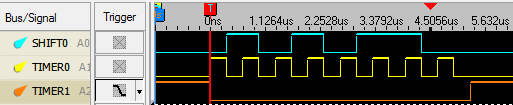

The FlexIO module supports automatic start and stop bit handling. All you have to do is change the SHIFTCFG and the TIMCFG configuration bits. In the SHIFTCFG register set SSTOP to 11 if you want the stop bit to have the value 1, and set the SSTART to 10 if you want the stop bit to have the value 0. In the TIMCFG register set the TSART to 1 and the TSOP to 10.
The transmission will look as the following image. Data transmitted 0x0F.
Figure 5. Transmission with start and stop bit

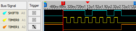

Changing the phase of the clock is very easy, you just have to set the TIMPOL bit to 1 in the SHIFTCTL register.
Figure 6. Shift on negedge of Shift clock

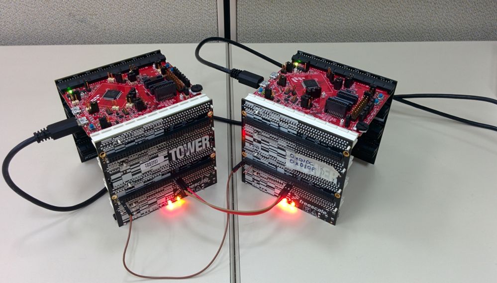

The hardware connections are shown in the following table.
Signal name
TWR-KL43Z48M transmitter
TWR-KL43Z48M receiver
Pin name
Board Location
Pin name
Board Location
Serial Data
PTD0/FXIO0_D0
B46
PTD0/FXIO0_D0
B46
Clock
PTD1/FXIO0_D1
B48
PTD1/FXIO0_D1
B48
Chip Select
PTD2/FXIO0_D2
B45
PTD2/FXIO0_D2
B45
GND
GND
B2
GND
B2
Table 1. Hardware connections
Figure 8.

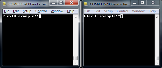

The example projects for the FlexIO transmitter and receiver are developed in KDS 3.0.0 with KSDK 1.2.0. The application lets the user communicate with the transmitter via a serial terminal and the transmitter sends each character to the receiver via FlexIO and the receiver displays the received character on another serial terminal.
To be able to compile the project, first you need to compile the library located in C:\Freescale\KSDK_1.2.0\lib\ksdk_platform_lib\kds\KL43Z4.
Once the two TWR-KL43Z48M are connected as described above, import both projects into KDS, compile the platform library, and both projects. Open two serial terminals configured to 115200 bauds and run each project on a different tower.
On the transmitter terminal you can write anything and it will be displayed and transmitted to the receiver tower via FlexIO and will be shown on the other terminal.
Figure 9. FlexIO example application. Transmitter (left terminal). Receiver (Right terminal).

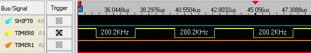

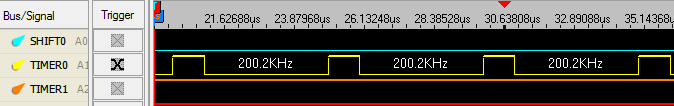

The FlexIO module is also capable of generating a PWM signal by configuring one of its timers to the Dual 8-bit counters PWM mode. This mode is configured by writing 01 to TIMOD in the TIMCTL register. In this mode, the lower 8-bits of the counter and compare register are used to configure the high period of the timer output and the upper 8-bits are used to configure the low period of the timer output. The shifter bit count is configured using another timer or external signal.
To calculate the frequency of the PWM signal you have to add the lower 8-bits of the counter and the upper 8-bits and divide it by the FlexIO clock*2 (Only if the timer is configured to decrement on the FlexIO clock.)
The frequency of the PWM signal is given by:
f = (FlexIO clock)/(TIMCMP[15:8]+TIMCPM[7:0]+2)
To calculate the TIMCMP values to get a certain frequency you can solve the equation for TIMCMP
TIMCMP[15:8]+TIMCPM[7:0] = (FlexIO clock)/f-2
For example, let’s say we want a 200kHz PWM signal, by using the formula above and using the FlexIO clock of 48MHz, we get that the sum of the TIMCMP values must be 238. If we want a 50% duty cycle we need to write the value 238/2 to the lower and upper 8 bits of the TIMCMP register.
The waveform generated by these settings is shown in the figure below.
Figure 10. 200kHz 50% duty cycle PWM signal

This is the screenshot of the logic analyzer capture. I want the
