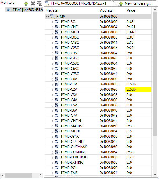

When I run the code and place a breakpoint on line 141 and 144 of FTM0Operation.c
at the same time I am monitoring the FTM0 registers.
When I hit the breakpoint on 141 the FTM0 registers provide this:

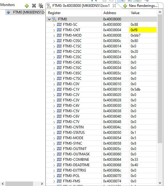

when I allow the code to continue to 144 the registers have not been updated:
Now if I reset the code and allow to run to breakpoint on 141, but single step through the FTM_UpdatePwmDutycycle() API, I find that the registers are updated.
Why does this not work when running?  why does it only work when single step is happening?  Is there a locking sequence that I'm missing?
