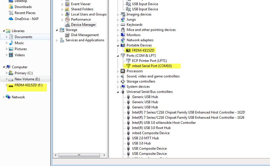

      You can download the CMSIS DAP to your board again
     1) Power off the board
      2) press the reset  button and hold it, then plug the usb cable to the board, you can find the device named as"DAPLINKBOOOT", then release the reset button.
      3)  Send k20dx_frdmke15z_if_crc_0241.bin to "DAPLINKBOOOT"
     4) power off the board, power on it again, you will find device named as FRDM-KE15ZD

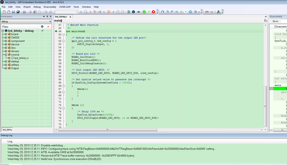

2. You can use the SDK code for FRDM-KE15Z, which can be downloaded from this link:
Welcome | MCUXpresso SDK Builder

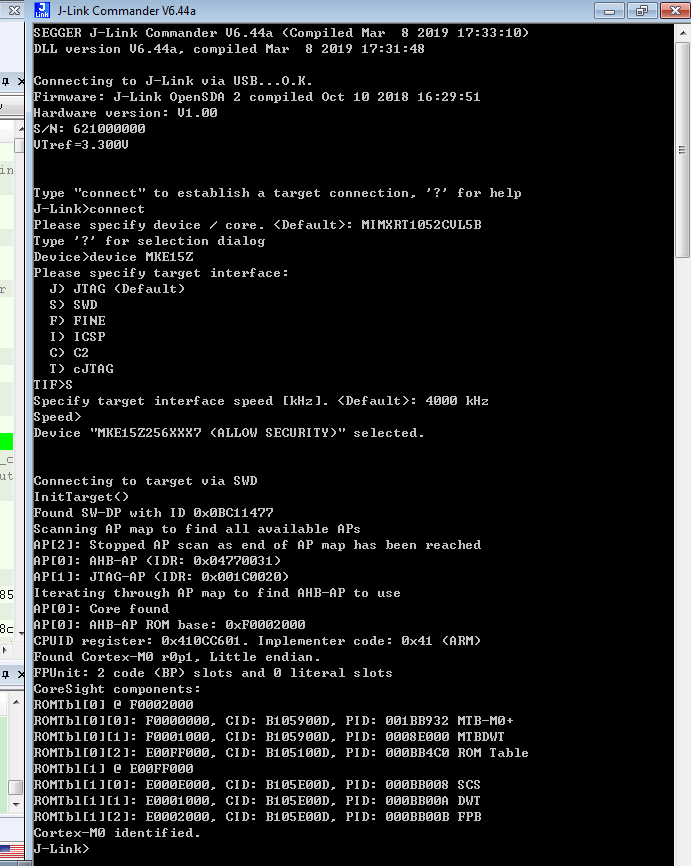

This is my debug result:
3. If you still have problems
    I suggest you change the on board debugger to Segger JLINK, then use the JLINK commander to connect your KE15z.
  JLINK driver download link:
SEGGER - The Embedded Experts - Downloads
JLINK firmware:
https://www.segger.com/downloads/jlink/OpenSDA_FRDM-KE15Z
 The steps to download the JLINK firmware to the FRDM-KE15  board is the same as the CMSIS DAP.
This is the JLINK commander connect result on FRDM-KE15Z with JLINK firmware.
You can try it on your side.
