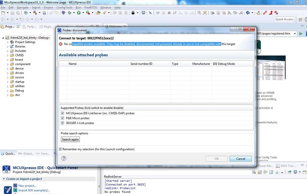

   I want to test a simple led blinky example code on Freedom K22f development board but i am unable to find the debug interface for connection in debug configuration. I have attached the screenshot of the debug configuration available to me. Please help in connectin gthe baord to MCUXpresso IDE.

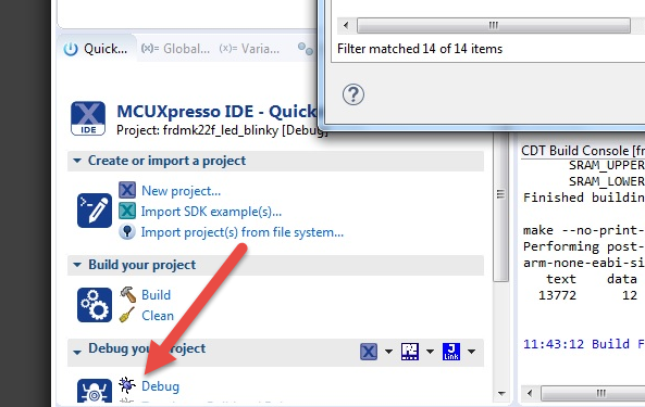

Hi Prasanna,
First, make sure you have the USB cable connected to the USB port on the board near the K20.
Second, use the 'blue' debug icon, this will automatically discover attached debug probes:
Or have a look at MCUXpresso IDE: Unified Eclipse IDE for NXPs ARM Cortex-M Microcontrollers | MCU on Eclipse  for an overview.

prasannanaik
Hi Erich,
   Thanks for your input. I have connected the usb cable to the board as well as the PC. I did try using the blue debug icon but got the following message
Prasanna

BlackNight
This means it does not detect any debug probe attached. Are you sure you have a debug firmware loaded on your K20 of the FRDM-K22F board? Or are you using Windows 10 and the device shows up as BOOTLOADER or MAINTENANCE on your host? In that case your Windows 10 might have erased the debug application/bootloader?
If this is the case, you have to reprogram the K20 with a debug probe, see
Recovering and Updating the NXP OpenSDA Bootloader with P&E Multilink and MCUXpresso IDE | MCU on Ec...
In addition to that, I recommend to stop the windows search as described in Recovering OpenSDA Boards with Windows 10 | MCU on Eclipse
