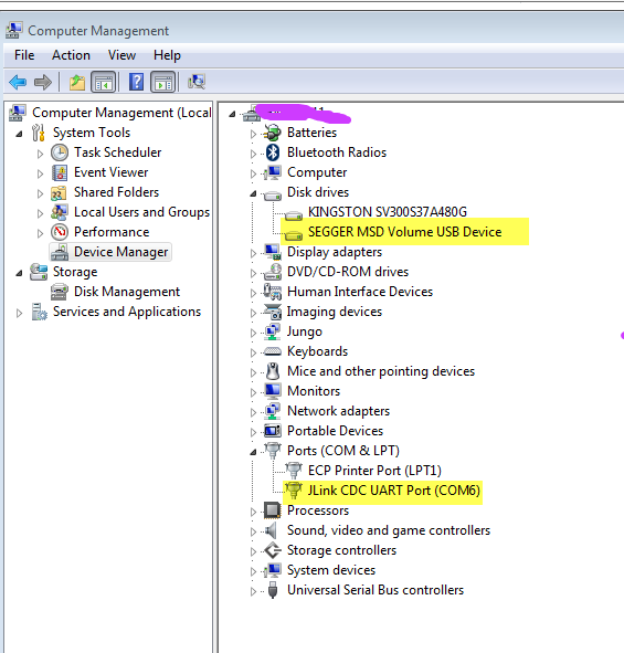

   Please check your device manager:
Can you find the debugger?
If you can't find it, please refer to Erich's reply, you may need to update the on board K20 firmware:
OpenSDA Serial and Debug Adapter | NXP
Kerry

BlackNight
This means it does not detect any debug probe attached. Are you sure you have a debug firmware loaded on your K20 of the FRDM-K22F board? Or are you using Windows 10 and the device shows up as BOOTLOADER or MAINTENANCE on your host? In that case your Windows 10 might have erased the debug application/bootloader?
If this is the case, you have to reprogram the K20 with a debug probe, see
Recovering and Updating the NXP OpenSDA Bootloader with P&E Multilink and MCUXpresso IDE | MCU on Ec...
In addition to that, I recommend to stop the windows search as described in Recovering OpenSDA Boards with Windows 10 | MCU on Eclipse
