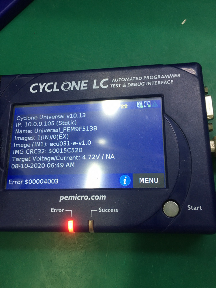

I USE Cyclone LC  Program the flash.  The MCU is KEAZ128,  when i use the  Security function.
the security data = 0xBF;
the program is error , Cyclone LC display the 4003 err  As shown below:
If i don't use the security function(security data = 0xBE), The program is ok.

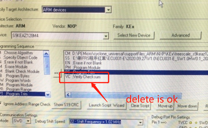

I  Set the Cyclone LC , delete the verify checksum.the program is ok.
I want to know if my operation is correct and if there is a risk,?
I use the MCU S9KEAZN32 also use the security function, but it don't have the Error. why?
thank you!

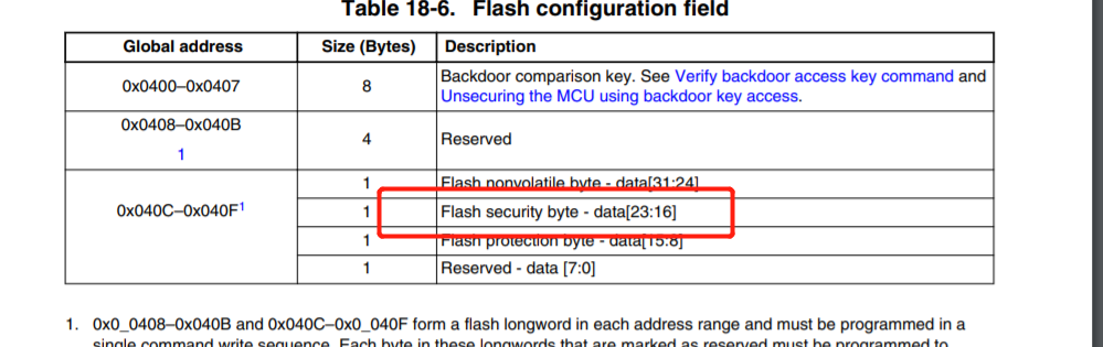

Hello @xiabin,
I think the reason of this error is this section right here:
The left one is the KEA128 and the right is the KEA32.
This command mention that will unsecure the device but the 4002000B address doesn't match with the protection register. Try changing it for the one in the KEA32.

HI:
      I edite the s9keaz128's arp file  like the picture.   but the error is same

Alexis_A
Hello @xiabin,
Could you try using any of the other two algorithms?
freescale_keaz128m4_pflash.arp
freescale_ke06z128m4_pflash.arp
Alexis Adnalon
4,242件の閲覧回数
xiabin
I USE freescale_keaz128m4_pflash.arp ,The Error is same
