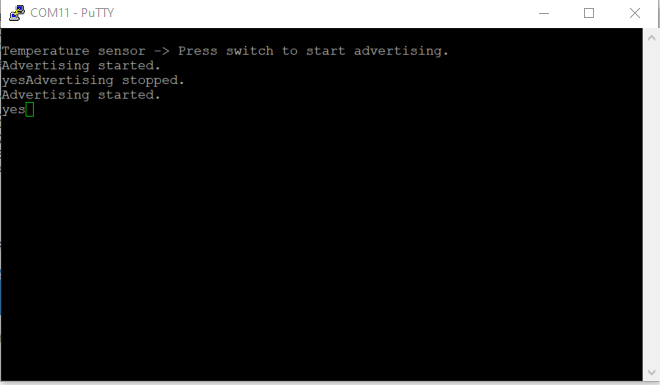

nxf56274
I do the test in the application, not in the function PWR_HandleDeepSleepMode_1(void). This function will go to sleep. then recover from the sleep. May be in some time, we can't access the variable in this function. I add code in function BleApp_AdvertisingCallback.
if(A == 3)
AppPrintString("yes");
Here is the result.
At first , print yes. Then mcu go to sleep. I press button to wake. Print yes again. It means the variable doesn't change.
