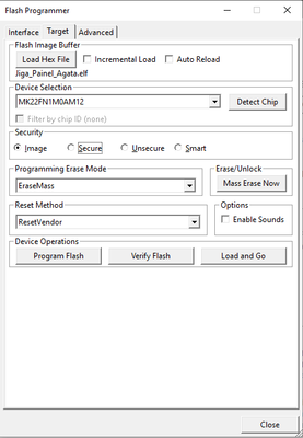

I'm using the USBDM ARM Programmer to program my board that has an MK22FN1M0AVLQ12.
After programming a test firmware it gets secured and i'm not able to mass erase.
Security option is set to IMAGE.
FTFL_FSEC us 0x00, so Mass Erase should be enabled.
Is there anyway that I can erase this MCU so I can program a new firmware?

Just found a way.
I forced RESET pin to GND and hold it while used the Mass Erase function of ARM Programmer.
