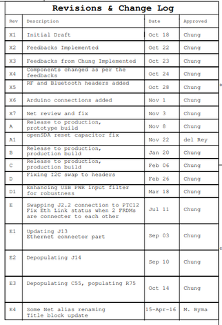

I bought the new FRDM-K64 boards with REV E .
I am trying to flash the program into board by using MCHXpresso IDE 11.5.0 and J9 and always got error to connect.
But, when I use the old board with REV C and everything works fine.
Can anyone tell me the difference between two boards?

 Can you tell me where to get the latest document for REV E and SCH F1 because I follow your link to download the document and is not latest?

You can find the FRDM-K64F Schematics E4 version at the following link, in the window called "Design Files". Additionally, the only user's guide available for the FRDM-K64F is the one I provided to you.

The schematic includes detailed information about the modifications made to the board. For instance, the change log for the REV E4 schematic outlines these updates:
In the other hand, I highly recommend see the Getting Started with the FRDM-K64F in order to obtain more information.
