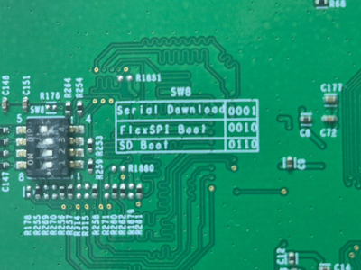

This is the EVK key that I am changing to put in Serial Download or FlexSPI Boot

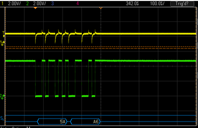

I made some measurements with an oscilloscope and put the images below:
1 - UART of the iMX RT1024 EVK.
EVK turned on with SW8(10 - FlexSPI Boot) working with the code of the evkmimxrt1024_lpuart_polling example

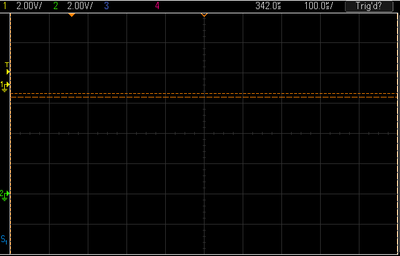

2 - UART of the iMX RT1024 EVK
EVK turn off with SW8(01 - Serial Download) and app blhost.exe sending ping command

Apparently, when the EVK is turn on, connected in UART and configured in Serial Download mode, app blhost.exe isn´t sending the ping command.
