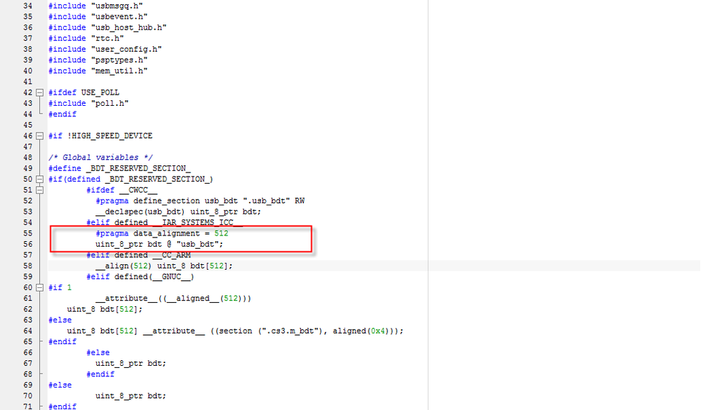

The USB OTG module in Kinetis parts uses a Buffer Descriptor Table (BDT) in system memory to manage USB endpoint communications, the BDT is a a 512-byte buffer and there are 3 registers in USB module to contain the base address for it, and it must be 512-byte aligned otherwise there would be issue during transfer.
In USB stack ver 4.1.1, some Kinetis old parts like K60N512, K20D72M have the demo project basked on CodeWarrior ARM compiler, and in khci_kinetis.c, bdt is defined as following:
#define _BDT_RESERVED_SECTION_
#if(defined _BDT_RESERVED_SECTION_)
#ifdef __CWCC__
#pragma define_section usb_bdt ".usb_bdt" RW
__declspec(usb_bdt) uint_8_ptr bdt;
but since the base address is defined as below:
#define BDT_BASE               ((uint_32*)(bdt))
so the bdt definition is not correct , and we have to change it as below:
#ifdef __CWCC__
__declspec(usb_bdt) uint_8 bdt[512];//uint_8_ptr bdt;
and the definition for usb_dbt section can be found in MK20X256_flash.lcf.
with above modification, we can make the demo of "msd_mfs_generic" work well as expected.

The same issue IAR tools, when user build the stack with IAR, bdt is defined as below:
Since there is no section defined as usb_bdt, it would be pointed to 0x00000000 where internal flash is, so would cause bus error issue. It is fixed after changing the definition as the following:
#elif defined __IAR_SYSTEMS_ICC__
      #pragma segment = "usb_bdt"
        #pragma data_alignment = 512
      __no_init static uint_8 bdt[512] @ "usb_bdt";
Hope that helps,
B.R
Kan
