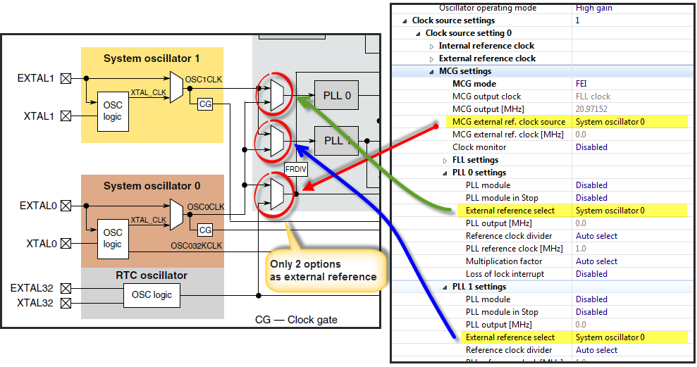

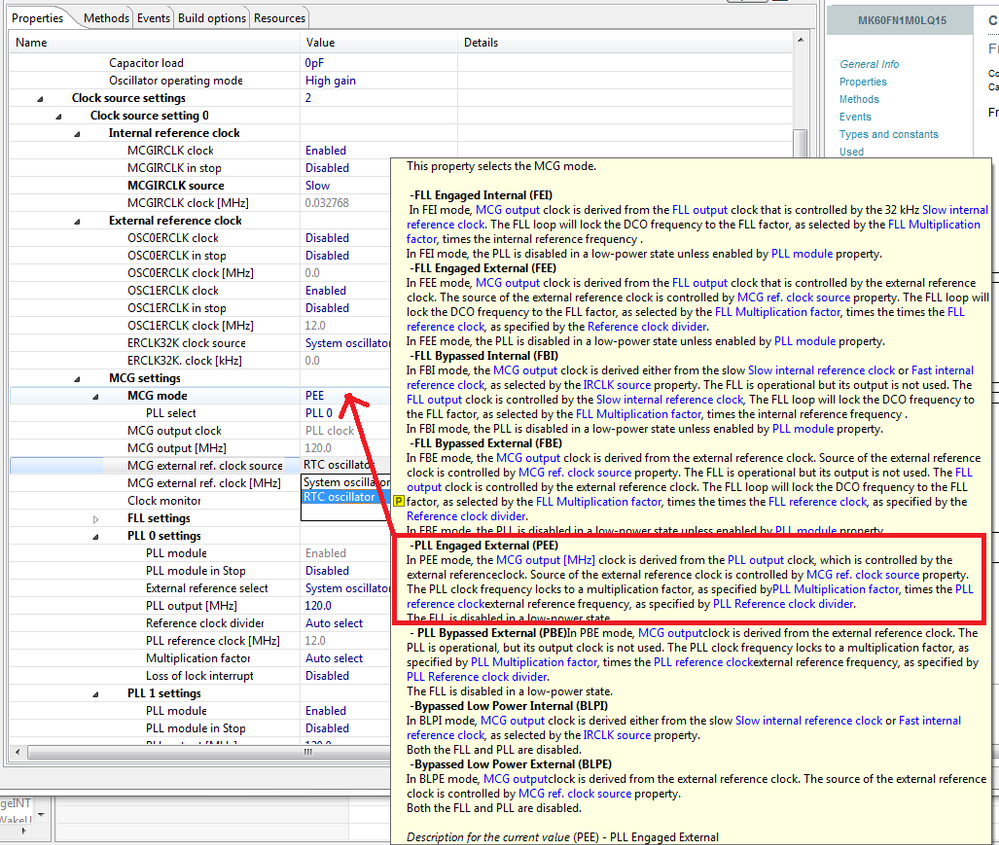

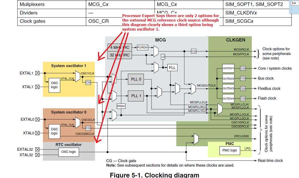

I was looking over my clock settings in processor expert and noticed that under Clock Source Setting 0 I can't select oscillator 1 as my MCG external referece clock source as seen below.  I currently have it set to RTC because there is nothing connected to oscillator 0, i.e., I don't have a crystal or reference clock connected to it.
According to the datasheet, there is clearly a third option which is System Oscillator 1 as seen below.

I honestly cannot help you with your USB problem, but I can help with your last question about clocks. You have 3 oscillators but only 2 of them (OSC0 and RTC) are selectable as external reference. The OSC1 can be used as reference for the PLL0 and PLL1. If you look in the PLL section, you will find OSC1 as an option. Check the next image:
Hope this clarifies your doubt about clocks.

I re-read your comment about the clocks and thought of another point to make.  In your diagram you showed that the MCG mode is FEI which means that you will be using FLL rather than PLL which explains your point that the third MUX only has 2 options.  This is because FLL can only be used on the 32 kHz internal clock or OSC0.  In my particular case I'm using only PEE as my MCG mode which means that I'm using PLL and not FLL.  According to PE documentation the PEE's MCG output comes from PLL (i.e., PLL0 or PLL1) and PLL gets controlled by an external reference clock, below is a snippet from PE's help that pretty much says the same thing.  From the clock diagram it appears that the MCG external reference clock options for the PLL MUXs should be either OSC1 or OSC0 and not OSC0 or RTC right?

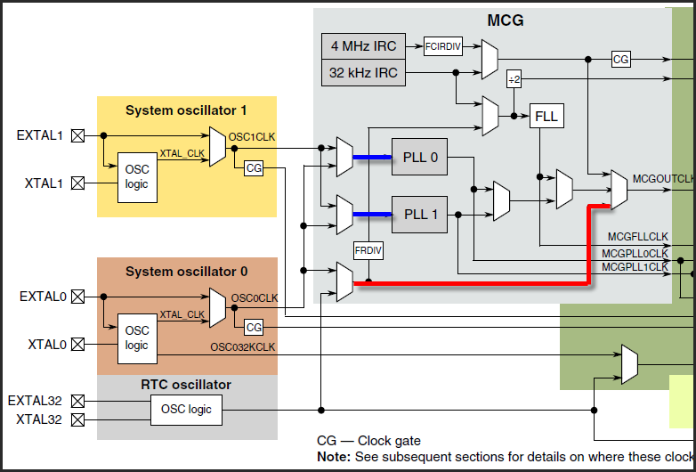

I think I can see you confusion here. You are confused by the repeated use of the words "External reference" for actually different things. This is a weakness in our documentation and in processor expert settings as well. In the next picture I try to show you my point:
1) In blue lines, are the "External references" for PLL0 and PLL1. These lines accept OSC0 and OSC1.
2) In red line, the "External reference" BUT for the whole MCG module. This clock is used as MCGOUTCLK in PBE, FBE and BLPE modes. This only allows selecting OSC0 and RTC.
I hope this is more clear.
