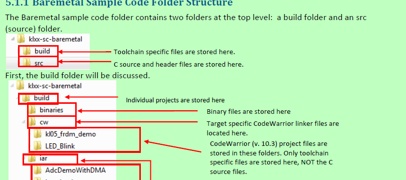

Hi pro,
I'm newbie to ARM. I'm working in Kinetis KL05Z.
I have a question about manage the project.
I see on the window "code warrior project" , there are many files. I'm really confuse about the function of each of file.:smileyconfused:
does anyone give me overview of them ? and please let me know what important file that i should take care when I work with GPIO or ADC module , for example ?
Thanks a lot,
Minh.

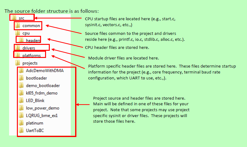

kerryzhou
Hi Nguye Nhat Minh,
   1:  I don't know what project you are used, but if you are working in kinetis KL05Z, we have a freedom board about it , and there has a sample code package.
    The sample code download link is :
http://www.freescale.com/webapp/sps/download/license.jsp?colCode=KL05-SC&location=null&fasp=1&WT_TYP... and Test Software&WT_VENDOR=FREESCALE&WT_FILE_FORMAT=zip&WT_ASSET=Downloads&Parent_nodeId=1359130311707695721244&Parent_pageType=product
    After you download and setup, you will find there has a FRDM_KL05ZSCG_CW_rev2.pdf.
    In this pdf, chapter 5.1 tell you the folder structure, and tell you the folder function, just like the following:

5,203 Views
nguyennhatminh
Thank you Erich for quickly overview.
Thank you Xuguang for useful instruction.
Minh.

BlackNight
This post lists and explains the different files:
Dissection of MCU10 Projects | MCU on Eclipse
5,203 Views
