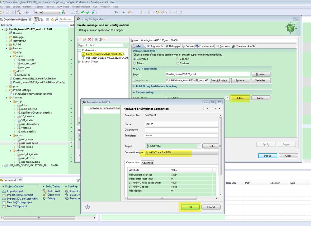

   Now, I think your main problem is the download problem.
  When you use the CW, you can download by click: RUN->Debug configuration, then choose the debugger which you are using.
  Take an example, I am using the JLINK:
  After the above configuration, click debug, you will download the code to your chip.
 If you are using other debugger, just choose the according debugger, for example, opensda or P&E multilink.

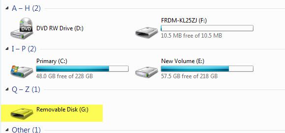

 Another important points you need to take care, even you download the code to your chip, you will ask to format the disk, but you will get the format failed.
It is because the KL25 doesn't have enough RAM, you can find details from this link:
https://community.nxp.com/message/431558#431558
Wish it helps you!

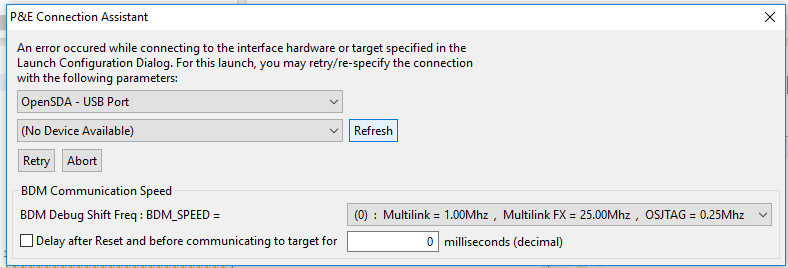

3,323 Views
arthshah
p&e error.pnghello kerry,
here is my screen shot of error.
3,323 Views
kerryzhou
Hello Arth shah,
    1. Please give me the picture in the debug configuration.
     Click edit button, it will turn out the hardware or simulator connections.
    2. Please check the computer->device manager, can you find the opensda port?
    3. You can install the P&E driver again.
     The driver download link:
       http://www.pemicro.com/downloads/download_file.cfm?download_id=53
Kerry
3,323 Views
arthshah
hello kerry,
i had just installed driver again and my issue is now resolved.
many thanks to you for the help.
but i can't show my board as a removable disk.
i connect usb cable to my usb port but still not show disk drive what is the problem now?
please give me suggestion or  help.
thank you..!!
3,323 Views
kerryzhou
Hi Arth shah,
   Connect both two USB cables to your FRDM-KL25, and try again.
   Do you have the format disc window?
Kerry
